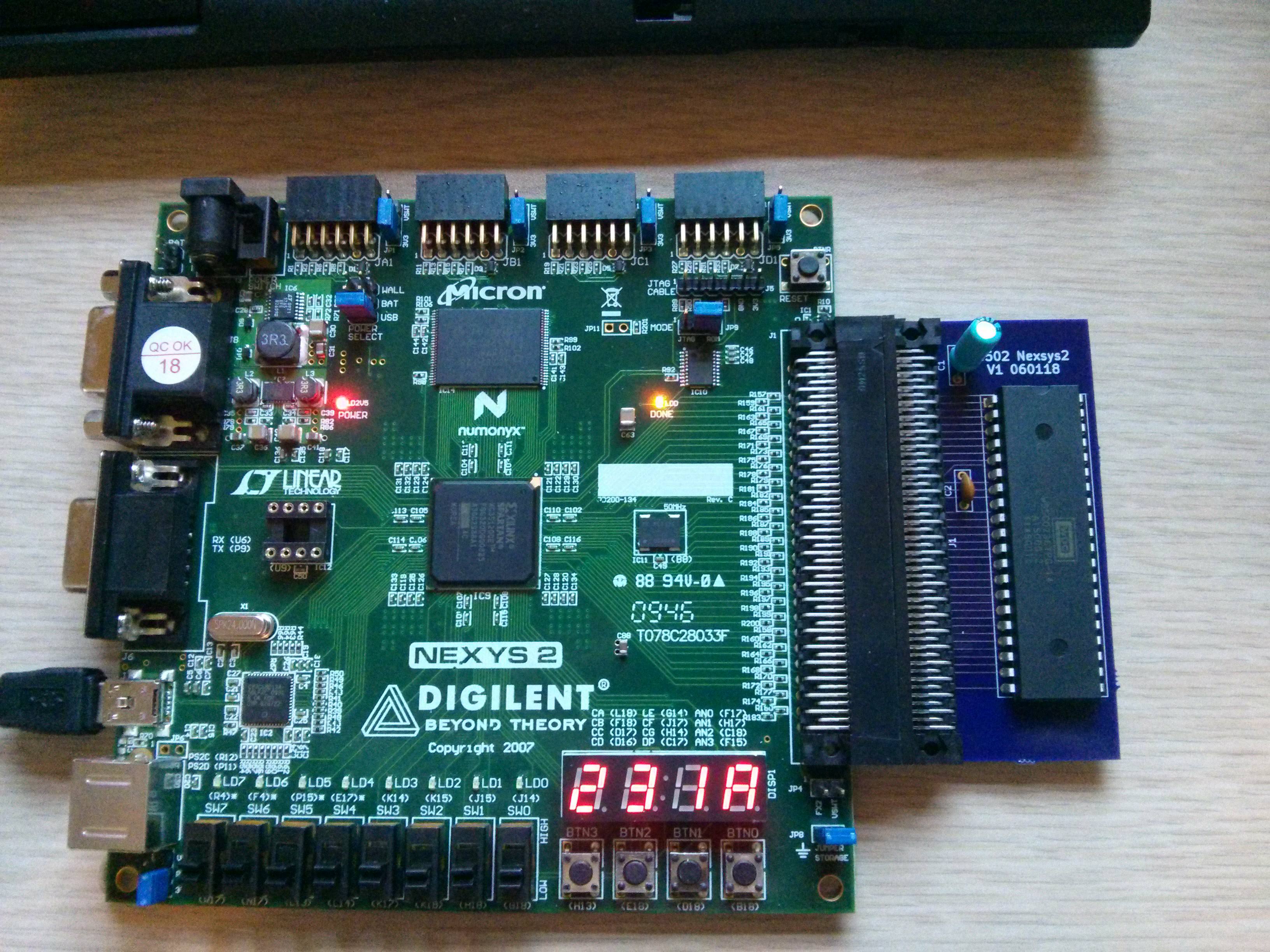

Can you let me know your thinking behind the preference? The Hirose connector is around 7cm long... Reasonably similar to the DIP, so as I'm planning on simplest signal routing, it'll actually be both simpler with a DIP and it will make for a shallower board (as the PLCC is wider than the DIP).
I'm off on vacation soon, but once I'm back I'll order the parts. In the mean time I've created a connector model for Eagle CAD. I realized that it's not clear to me how the pins from the Digilent side of the connector map to the ones on the 6502 side, so I'll get the parts and figure it out using a meter before I draw the PCB (measure twice, cut once... I'm in no hurry).
This will be my first attempt at building a board, so I'll see how I get on with OSH Park. This thing is so simple even I can't mess it up (challenge accepted!). But as long as I don't do something extraordinarily stupid, like short the FPGA board, I should at least be able to get some life out of the processor... Even if it's just fetching NOPs.

There are pros and cons, so if you prefer DIP then that's probably enough to tip the balance. PLCC uses less board area and has better ground and Vcc connections. But the latter point is diluted somewhat if the PLCC is socketed.
Unless you need the speed, you might want to consider using a 65C02 other than the modern WDC product. The WDC have significantly faster slew rate on their outputs compared to, say, a Rockwell. Also the Rockwell offers less drive current, and that's an advantage should you ever stumble into a situation where a 'C02 output is in contention with an FPGA output.
Edit: another option is to use the WDC CPU but allow space on your PCB for a SMD series resistor on every pin capable of being an output.
We'll be following your progress with interest... after your vacation. :) Hope it's a good one!

Here's a quick update. My board came back from OSHPark this morning. I soldered the connector and 65C02 and powered it up. Here's a photo:
The 6502 is running code from the Micron SDRAM attached to the FPGA.
I'll post some more progress once I get it to do something interesting.
