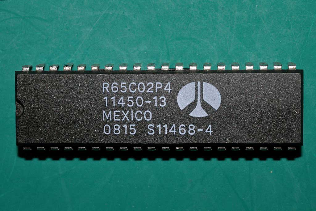

Here is an R65C02 I bought as part of a batch from polida2008 about 6 years ago.
It is either genuine, despite the 2008 manufacture date, or it is a real fine copy. I know this because:
A) It only draws 10mA while running at 4mHz
B) It works perfectly in an enhanced Apple IIe with a microdrive card installed. An NMOS 6502 or one missing the R65C02 instructions will not even boot under these conditions.
If it is genuine then we can assume that someone was still cranking these out as late as May of 2008 or that the date code is in error.
If no one with the rights to the name Rockwell was making these back in 2008 and it is a 'copy', then it is a damn good copy and worth the ~$2 I paid for it. However, I cannot see someone starting up the process to make these for $2 or less a pop considering the demand for them might be in the 100's per year.
So I'm going with - if it looks like a duck, quacks like a duck and walks like a duck, its a duck. I think someone with the rights to the name Rockwell and the logo were manufacturing these in Mexico as late as May of 2008.
Maybe we are all getting too cynical.

These falsely marked CPUs are not copies. They were pulled out from old PCBs, their pins were straightened and pulled at an angle to look like new chips, then the chips were remarked to look like new. Many remarked chips are false (like NMOS marked as CMOS) but some of them are real - see my case of remarked Z84C00 and V20. It's just that their marking is new and looks like new. I don't know how many companies back in 1990s were laser-engraving the chips (some did). I didn't see any original WDC, Zilog or ST chip made in 1990s with laser markings. The counterfeit ones are laser-engraved. Well, not all of them - the mysterious Rockwell R65C02s from 21st century are nicely painted.
Most remarked chips have the same date codes. My set of 5 V20s has different date codes, although the rest of marking is identical. And they ARE REAL, working V20, just remarked as HCZ-16 version.

Hmm...possibly.
I just can't see why someone would go to all the trouble to remove the marking from R65C02P4 chips, re-dress the tops to look like virgin plastic, straighten the pins and place them at an inserter angle then re-mark them as R65C02P4 chips with dates like '86, '93, '06 and '08 then sell them as 'new' for $1.30 shipping included. It seems like a bad way to make money. I don't know about you, but I would pay $1.30 each for them if they were used.
But nevertheless, it is all just speculation unless you have irrefutable evidence that there were no R65C02s made in the 21st century.
I'm sure there are some brain dead folks out there re-marking $8 Synertek, Rockwell or MOS NMOS chips as $1.30 CMOS chips, or undertaking the laborious routine mentioned above, but I'll bet it's not everybody on eBay doing it and I'll bet they won't be doing if for very long.
Again, if it quacks like a duck .... I'll pay $1.30 for a working R65C02P4 regardless of how pretty the top of the chip is.
Sure, I can see some scurrilous folks marking a cheap and cheerful R65C02 as a WDC W65C02S to make a few illegal bucks, but I find the other stuff is, at least with 6502s, to be a bit of a stretch.

Those 10 R65C02P4s I ordered from polida2008 recently have arrived and have been tested.
All are CMOS.
All will run at 5mHz or better.
All have the date code 9326.
Some have had the printing removed from the bottom (or never had any).
All are obviously used and seem to be pulls from soldered-in applications. However, they were sold as 'New'.
All in all, for $1.30 ea. delivered, I'm quite happy with the deal.
