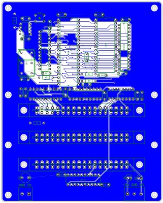

In any case, I have a question for those more seasoned in this stuff.
Id you have a typical 4 layer board:
Signal
GND
Vcc
Signal
Is there a preferred reference plane (GND or Vcc) to run traces over, if you have a choice? In other words, for the layout above, is better to run traces om the top (closest to GND) or on the bottom (closest to Vcc) or does it not matter?
Oh, also ... I was talking with a guy I know recently about me little 14mHz 6502 project. He recommended two things to me. 1) make the board larger than required in order to have a wide margin around the circuitry to reduce impedance in the GND and Vcc planes. and 2) Use copper pours on both the top and bottom to further reduce impedance on the power supplies providing these copper pours completely enclose the circuitry by a wide margin (see attached image).
What do y'all think of these suggestions?

PostPosted: Tue Mar 20, 2018 8:45 pm

BillO wrote:
You probably won't have much choice. One layer will have to be mostly going north and south, and the other, east and west (so to speak). Once it's mostly in, you can start changing some traces and segments to minimize vias. If the edge rates compared to the board size are fast enough to matter, there should be a bypass capacitor from the ground layer to the Vcc layer right near the via. The principle is illustrated in Figure 14 and described in the surrounding text, although there they have multiple ground planes. Ideally, the Vcc plane serves as an AC ground plane just as much as the ground plane does, being bypassed with capacitors in all the right places; but it's not possible to have the bypass capacitors' connections free of inductance, unless you put the capacitor in the board, like I show at viewtopic.php?p=16095#p16095 . When you have a chance to move traces from the Vcc side to the ground side, that's probably good.
That's to approximate the effect of a pair of infinite parallel planes, which, as I understand it, result in no inductance. If you have .020" between layers, having something like .100" from the most outlying traces to the edge of the planes should do the job. It's not like you need a half inch out there.
If you do what's in the paragraph above about approximating infinite planes, the impedance is already basically zero, or at least dwarfed by the impedance of the IC lead frames and bond wires. The pours won't add any benefit unless you have lots of vias from the edge of the pour to the ground plane, especially next to signal vias. You could look up "coplanar waveguide" and "via fence" but the speeds of current 65xx OTS parts don't warrant going to that extent. [Edit, four years later: There is a way to use them to supplement real planes; but if they're not done correctly, they can actually make things worse, according to experts in the field like Rick Hartley, Eric Bogatin, and Suzie Web whose lectures you can see on Altium's YouTube channel.]
PostPosted: Tue Mar 27, 2018 1:17 pm
Posts: 1001
Thanks Garth,
The board is the size it is for the convenience of fitting into the casing, so that's not an issue in this case. Thanks for the tip though.
I followed your process advice on changing traces and eliminating vias. I was able to shorten the over-all trace length by about 30cm and reduce the vias from 74 to 33. I spent another 10 hours pouring over it and was not able to see a way to eliminate one more via, so I guess 33 is it.
To even eliminate the 41 I did took some rather unusual pains (at least for me) to accomplish. They included tossing out a 74373 in favor of a 74573, using 74245s instead of 74244s (you can define their direction without flipping them around), redefining the pinout of the GAL and taking advantage of the fact the order of address and data lines going to RAM and passing through buffers and data registers is immaterial (not so with I/O devices and ROM - for obvious reasons).
It is unfortunate that the 6502 pin-out is so at odds with the pin-out of memory chips. That is the single largest contributor to the via count.
After reading some published info on copper pours, I have decided to pass on these. They can certainly cause more trouble than they solve in digital circuitry.
PostPosted: Tue Mar 27, 2018 6:55 pm
Posts: 8438
Remember that on SRAM, you can mix up the address lines, and you can mix up the data lines. This is the first tip in the "Tip of the Day" column I ran 17 years ago. (Wow how time flies!) You can do that with ROM too, but you'll need either a programming adapter, or you'll need to pre-scramble it in software before programming.
