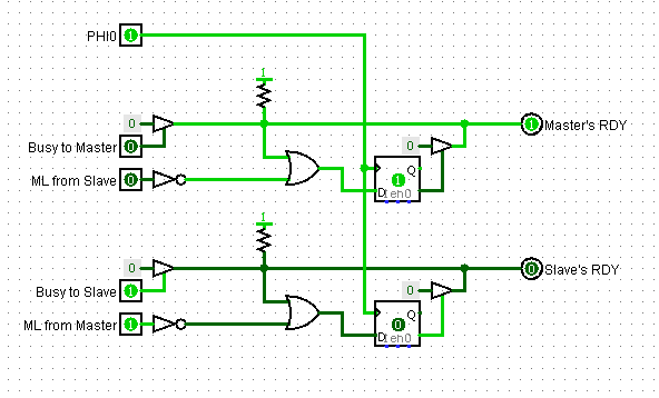

PostPosted: Sat Mar 24, 2018 2:27 am
Posts: 362
How about this circuit?
Note that the two controlled buffers are not "part of the circuit", they're just there because logisim cannot directly emulate open-drain pins. Also note that Busy to X input and ML inputs are inverted (that is, active HIGH) on this diagram; hence that inverter is also not a part of the circuit.
Anyway, what happens is normally ~BUSY is passed to RDY unchanged. ~BUSY is normally asserted by the bus arbiter if both processors try to access the same RAM location at the same time. However, if ~BUSY and ~ML are asserted simultaniously, then that gets saved into the D Flip Flop, causing RDY to continue to be held low - even though ~BUSY would normally be released during PHI2 low because of the way the bus arbiter works. RDY will not be released until ~ML is released, which based on the infamous Table 5-7 in the 65C816 datasheet, should not happen until the part of the R-M-W instruction that needs to remain atomic has completed.
Thoughts?

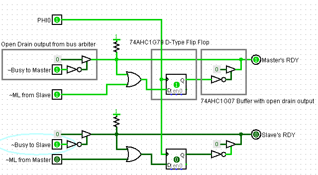

PostPosted: Sat Mar 24, 2018 2:59 am
Posts: 362
Here's the same circuit again, but with the signals active low as they are in the real deal, and annotated to show how it might be built out of actual glue logic.

PostPosted: Sat Mar 31, 2018 9:44 pm
Posts: 362
Just complete to the discussion, I figured out that you need a diode, pointing left on the diagram above, with pull-ups on both sides, otherwise there is a rare circumstance involving WAI where the system could become deadlocked.
Your TSB/CMP solution is interesting, though I prefer the speed of the hardware solution. I'd probably have to use the TSB/CMP method if more than two devices were sharing the same RAM, luckily the architecture I have is each slave has its own shared RAM - so slaves are not aware of eachother, only the master.
