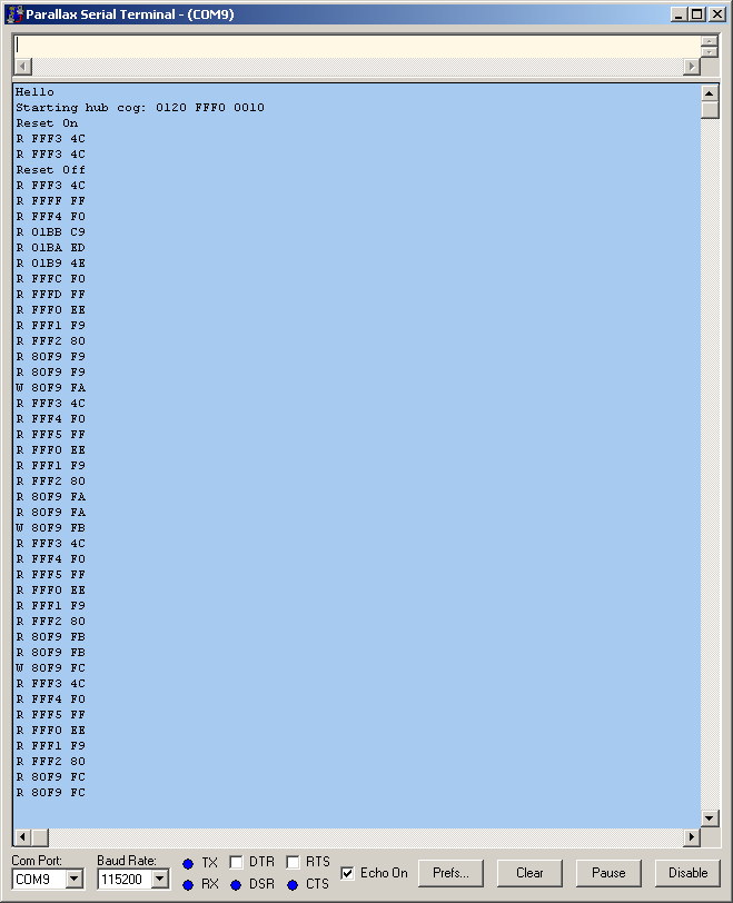

What happens whilst the Reset pin is being held low?
I know what happens when the pin is released after being held low, the chip goes through its normal and well documented reset process, but what does it do before it is released?
PostPosted: Thu Mar 22, 2018 9:13 pm
Posts: 229
The data bus is held in High-Z mode. That's pretty much the most important thing.
The address bus stays online and doesn't change between clock pulses while RESET is active.
You have to keep RESET active for at least 2 clocks or it doesn't work correctly. I don't know exactly why this is the case, but I suspect that it's necessary because the reset sequence is basically handled like a pretend-interrupt. So it finishes the current instruction to get the instruction decoder to state T0.
You probably already know that after RESET goes inactive (high) again, the 6502 reads one more instruction, then pretends to push the return address and flags onto the stack but holds R/!W high to keep that from happening, and then it loads the address from $FFFC/$FFFD and starts executing at the address that's stored there.
Here's a page I wrote a couple of years ago on my old Propeddle project website that shows the address bus and databus during and after a reset: http://propeddle.com/?p=162 (I've abandoned that project and am now working on a simplified version called L-Star, see http://l-star.org).

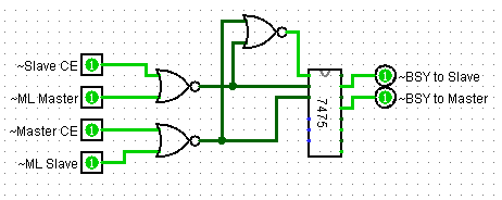

The reason I ask is because I'm designing a system where the 6502 CPU is a "slave" to another processor with some shared RAM between the two. To bootstrap the slave, the host can write a small bootstrap program into the shared RAM whilst the slave is being held in reset. Once its done that, it releases the slave which then bootstraps itself using the program & vector left for it by the host. The problem is that the dual-port RAM would perma-block the host if the slave is attempting to "write" to the shared RAM due to some weird consequence of being held in reset. It sounds like this won't be an issue due to R/W being held in the read state.

On a related note, ~ML is breaking my brain.
Obviously this a multiprocessor system with shared RAM, so I need to use ML to protect the atomicity of RMW instructions (or ban their use on shared RAM); which is easy enough, I just connect ~ML into the ~BUSY signal going to the other CPU, which causes it to wait until ~ML is inactive. The problem is what happens if both Slave and Master happen to assert ~ML at the same time? They'd both be halted and never recover.
I guess I need a circuit or system of some kind whereby ~ML works as described above, EXCEPT if they're both asserted in the same cycle, in which case one is given priority and the relevant CPU allowed to run to completion whilst the other is made to wait (e.g. using RDY). Ideally ~ML blocking should only happen whilst accessing shared RAM, for which there is a chip enable signal called ~SRCE.

PostPosted: Fri Mar 23, 2018 12:43 am
Posts: 362
jac_goudsmit wrote:
The idea is not restrained to 2 CPUs. As long as only one CPU at a time has a clock that's in the HIGH state, you're good.
Good point, though it would somewhat defeat the point of having multiple cores (or at least, more than two), since they'd effectively be operating in a round-robin fashion rather than truly in parallel.
Also, I've thought about it a little more, and the high/low clock solution doesn't actually solve the underlying issue with RMW instructions (though I do agree is removes the need for dual-port RAM)....
Example:
CPU A enters an INC RMW cycle, reads out a '5' from memory.
CPU B, on the low half of the cycle, starts an INC RMW cycle, reads '5' from the same memory.
CPU A, writes back '5'+1 = '6'.
CPU B, writes back '5'+1 = '6'.
We now have '6' in the memory when we ought to have had '7'. Had ML been used to block CPU B, the answer would have been the correct '7'.
The circuit pictured in the attachment almost does what I need...
When the Slave attempts to access the shared RAM whilst the Master's ML is asserted then the BUSY signal to the slave is asserted, stopping it in its tracks until the Master releases its ML. The 7475 flip-flop ensures once one of the two BUSY signals are asserted, the other one cannot be asserted until both have been deasserted, since there's never a reason to block both simultaniously: this ensures forward progress is always made
All of the above is true of the reverse relationship as well.
There are two problems with this circuit: if the Master and Slave both assert their MLs or CEs in the same cycle with either or both of the other signals also asserted, then both BUSY outputs might be asserted, halting all forward progress. The other problem is that the circuit unecessarily stops the Slave when the Master's ML is asserted but it is not accessing the shared RAM (i.e. Master CE is not asserted), and vice-versa.
EDIT: ... and I just thought of another complication. Say Slave CE and Master ML are asserted, so the slave gets halted by BUSY. Now the Master continues and happens to access the same memory address that the Slave was in the middle of writing - because BUSY is hooked up to the 6502's RDY input, the address bus etc on the dual-port RAM is still on the same address. This causes the dual-port RAM to report a contention, which causes it to assert the Master's BUSY signal. Now both BUSYs are asserted and no forward progress is possible. Though actually this may not be possible since ML is asserted first during a read, so maybe the blocked side would always block on a read, which would be OK? .... maybe it would just be easier to ban RMW instructions on the shared RAM, this is getting complicated.
File comment: Incomplete example circuit

PostPosted: Fri Mar 23, 2018 10:08 am
Posts: 362
if CPU A is executing an INC absolute of a location, any other CPU should ONLY be halted if it tries to access the SAME address. Accessing any other address is fine. But that would be a complicated circuit.
Luckily there's already something that does that in place.
The dual-port RAM already has built-in bus arbitration based around memory contention: if both Master and Slave attempt to access the same address at the same time, the bus arbiter will allow the "first" one to finish and inhibit the second by pulling BUSY low (which is connected to the relevant CPU's RDY pin). The problem is that this is done on an access-by-access basis, so that atomicity of RMW instructions are not protected: although the RMW instruction might win on one bus cycle, on the next it might not.
I guess that that means the following:
If Master's BUSY and Slave's ML are asserted at the same time, then Master's BUSY must continue to be asserted until Slave's ML is released, in order to guarentee that Master's accesses always win on every subsequent cycle, thus protecting the RMW's atomicity. And vice-versa.
This is probably a much more efficient idea, since a stall will only happen on actual memory contention, and the RAM's BUSY signal already ensures that only one of the two BUSYs will be asserted at one time, so we won't get a deadlock by making the continued assertion of BUSY dependent on BUSY being asserted in the first place.
