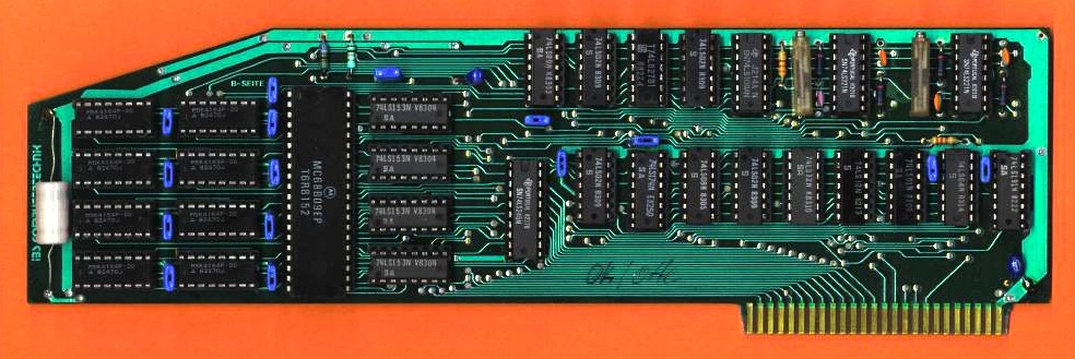

This add-in card for the Apple II is rather interesting:
- adds a 1MHz 6809
- shares memory with the 6502
There was another 6809 board from West-Germany, the IBS AP10:
This 6809 has its own 64kB RAM. Means that the 6502 runs parallel with full speed.
IBS developped some other coprocessor boards, i.e. the AP20 (68000) or AP21 (6511).
- can run FLEX or OS/9 or a PASCAL accelerator
Please, it's OS-9 ;-) There is no relationship to Half-OS from IBM.
- can cause the 6502 to lose state and malfunction, if the instruction mix contains too few dead cycles
The 65C02 should solve this problem.
Regards, Ralf

Oh, that's more like it! 64k RAM could be expensive though, in say 1983 - any idea what price this card would have been?
I just have a copy of a pricelist published in August 1985. Nothing else :-( They offered the AP10 for 895DM as "AP10 INTENEX 6809-64k mit Pascal" but I don't know what's the meaning of "with Pascal". There is no explanation. In 1985: 2.94DM were US$ 1.00.
Let me fix up my OS-9 error...
Microware, the company behind OS-9, wrote it OS-9. I know that even resellers and developers wrote it wrong.
Regards, Ralf
