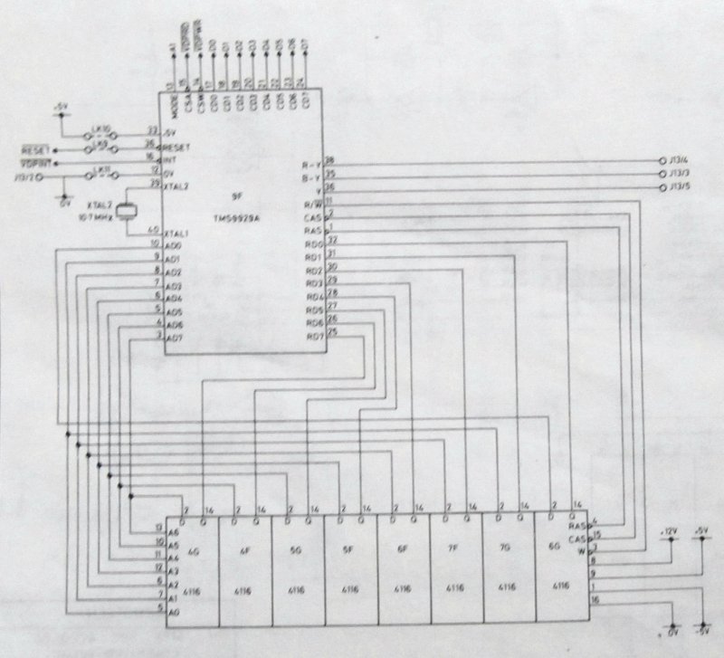

You could try just connecting a timing crystal across the 2 XTAL pins without any extra components.
See the schematic from the MTX500/512.
File comment: Slightly blurry shot of the TMS9929A section of the MTX500 schematic
NB The MTX is a Z80 system, but I don't think that makes any difference.

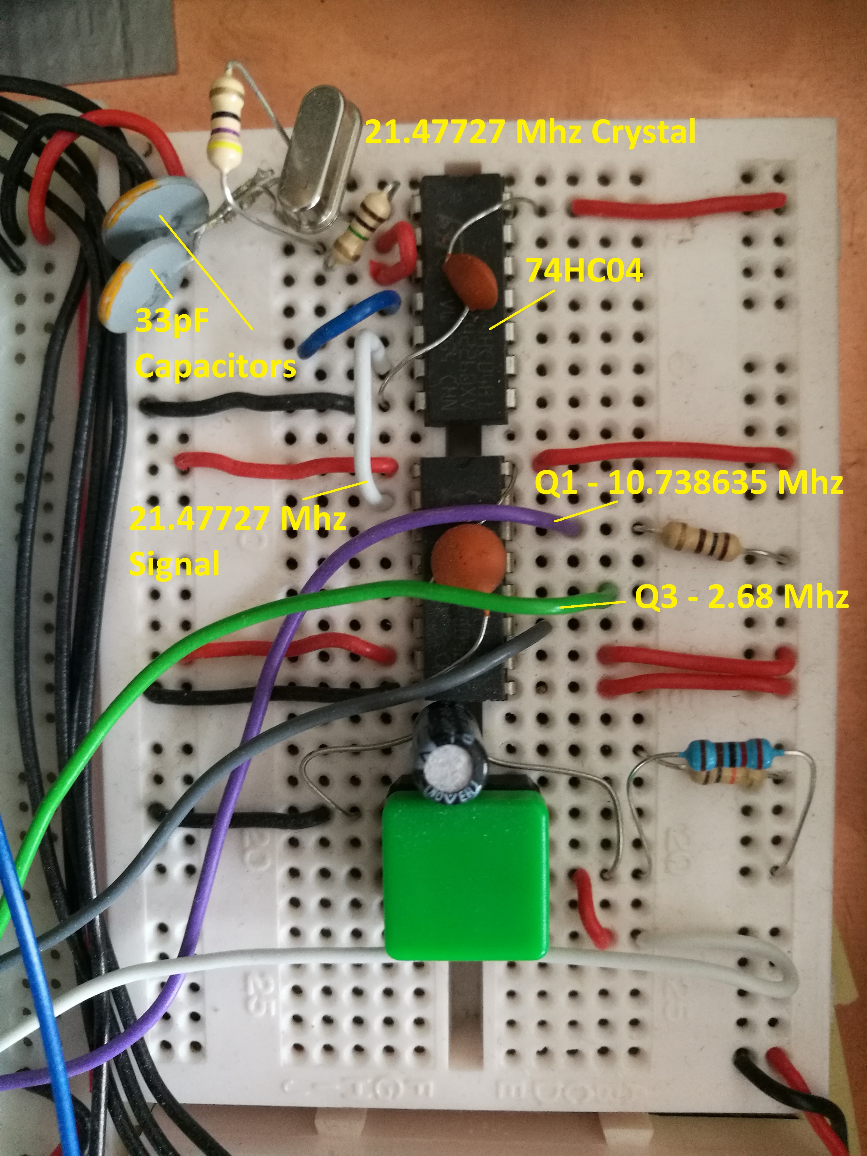

Hi folks. I have previously posted on this same thread quite some time ago, but have a stable working 65c02 and TMS9918a set up.
I have a 21.47727 Mhz crystal, struggled to get hold of a 10.738635 one - they seem to be difficult to find in the UK at least.
So I used that crystal as the master clock for my breadboard, fed in to a 74HCT161 counter and used Q1 and Q3 outputs to drive the TMS9918a (Q1) and 65c02 (Q3). In fact I use Q3 (approximately 2.68 MHz) as the clock for everything else as well as the 65c02 (6522, 6551).
The TMS9918 can be driven with an external signal, but needs clock signal and its inverse to be fed in to XTAL1 and XTAL2 - a NAND gate from a 74HCT00 achieves that for me so I get a clean non-overlapping Q1 and /Q1 signal.
I have never really understood what is going on with clock circuits - they seem to be the most analogue of all the sub-systems on my homebrew. So I followed various schematics on the internet (and this forum too).
Anyway, I attach a photo of the clock circuit, with a couple of annotations, hope it helps a little..
File comment: Main clock circuit DOLO-1
