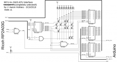

Yes! Schematic below. (My reply is delayed because I hadn't drawn one yet. It was just handwritten notes and thoughts.) I suppose "startup" was ambiguous. I should have said "power on." I wasn't referring to the reset time, but rather to the time between when power is first applied to the circuit and the time the logic gates find valid states.
...although I suppose the same concern (if real) would apply during operation as well--for example, if as some posts advise, one chooses not to pay attention to Phi2 for read-only devices. But if you have multiple ROMs in your system and a decoder (e.g. 74HC138) supplying the output-enables, might not a transition between two addresses lead to momentary "conflicts" on the bus if the transition causes one device to be selected and another to be deselected? I suppose this is a scenario that would suggest pull-ups on the OE pins (to hasten their disabling)? I see that being done in some circuits, though mainly for the 65xx peripheral ICs (Here's an example where this is done for the 6551 and others.) This isn't a situation that applies to my own circuit, I don't think, as it's easy enough for me to pay attention to Phi2, and my whole external memory system is read-only besides. (More on that down below.)
That's sort of what I thought, and I don't see people designing to avoid it. It feels like one of those "just don't worry about it" situations, but I couldn't help asking. No programmable logic in this circuit, no. Just 74HCxxx.
Here's the requested schematic: Doubtless this looks pretty strange, so here's the overdue explanation: The CPU in use is actually a Ricoh RP2A03G, the customized 6502 found in the Nintendo Entertainment System. The goal of this circuit is to give an MCU (Arduino) easy control of the internal audio functions of the 2A03, which are mapped internally at addresses $40xx. The MCU will (hopefully) just clock the data it wants to write into the BYTE4 flip-flop (IC5), clock the address offset xx into the BYTE6 flip-flop (IC6), and then assert NMI. The 2A03 should then perform the desired write.
The diode matrix implements the following code:
$0000: JMP $0000
$0003: LDA #$xx ; operand xx is supplied by the BYTE4 flip-flop
$0005: STA $40xx ; operand xx is supplied by the BYTE6 flip-flop
$0008: RTI
$000A: $03 ; this is the low byte of the NMI vector. A0-A3 are the only addr lines used, so this is also address $FFFA
Bytes not supplied by the matrix or by the flip-flops read as zeros. This includes the reset and IRQ/BRK vectors.
The stack is read-only, and will reside in the same physical location in memory as the interrupt vector table, most of which is zero. The result of this is that, when an NMI is taken, the stack pushes will go nowhere, but on RTI, PC will be restored by popping zeros from the vector table, returning execution to $0000--which is what's desired.
Phew!
Anyway. That's the idea!
$0000: JMP $0000
$0008: RTI
Phew!

Now that's an interesting idea and an interesting circuit! I'm a big fan of diode ROMs, perhaps partly because they are rarely seen. (I think it would be good for you to repost that in the hardware thread with a suitable title - you might not catch your audience in this thread!)

But you've made a minor booboo, I think. You said, on RTI, PC will be restored by popping zeros from the vector table, returning execution to $0000. But it seems to me you want a BRK, not an RTI. BRK reads vector table as desired. RTI uses the (uninitialized) stack pointer S to read something probably not desired!

In any case, your BRK suggestion is fantastic and seems like a clear winner. Let me reason it out: So, it doesn't matter to BRK that I'm already in the NMI handler, and BRK is endlessly reentrant (yes?), so I can use BRK to (effectively) jump to $0000. (And for a savings of one diode over RTI.) BRK will push the return address and status onto the stack (wherever that is), and as I'm BRK-ing like mad and never RTI-ing, the stack will eventually just wrap around (which doesn't matter in this circuit). If that works, I wonder: Might I also replace JMP $0000 with BRK? That would save me four more diodes (three for the JMP opcode, and one more because my NMI vector would go from $03 to $01). Presumably, if that worked, it would have a negative (but probably inconsequential) impact on my NMI handling latency.
Let me cogitate over this some more, because I certainly wouldn't mind cutting my diode count by a full third.
First, here's your original memory map (as I understand it) except I've replaced the RTI at xxx8 with BRK as discussed.
xxx0: 4C jmp abs opcode
xxx1: 00
xxx2: 00
xxx3: A9 lda# opcode
xxx4: ** (port)
xxx5: 8D sta abs opcode
xxx6: ** (port)
xxx7: 40
xxx8: 00 brk opcode (was: rti)
xxx9: 00 (not used)
xxxA: 03 lo-byte of NMI vector
xxxB: 00 hi-byte of NMI vector
xxxC: 00 lo-byte of RST vector
xxxD: 00 hi-byte of RST vector
xxxE: 00 lo-byte of IRQ/BRK vector
xxxF: 00 hi-byte of IRQ/BRK vector
; Plan A: the pattern as shown repeats every 16 bytes throughout all 64K
; Plan B: (discussed below) a similar pattern repeats every 16 bytes throughout lowest 32KMore subtly, and WRT using BRK as a replacement for the JMP 0000 at xxx0: some 65xx chips are vulnerable "interrupt highjacking," which is the gray-area behavior you get when a hardware interrupt is roughly coincident with a software interrupt (ie, BRK). Which vector will the CPU fetch? I don't know these details offhand. But I'm inclined to say it doesn't matter, as long as none of our NMI's actually get lost. To be on the safe side we could just keep the JMP 0000 at xxx0.

Hi Jeff -- Ah! You beat me to it. I was considering the now extremely underutilized second '138 and how to get rid of it. To make sure I understand the hijacking concern (which, according to the nesdev forums, is a valid concern on the 2A03): The BRK in the NMI ISR would be considered safe because it could be avoided by simply ensuring that the MCU provided sufficient delay between NMIs to prevent them from ever landing on it. Obviously, with BRK in place of JMP $0000, no (reasonable) timing tricks would guarantee safety. Yes? I think I'm keeping up.
Great suggestions, Jeff. I really appreciate it!
Re: Noob question: Tri-state logic chaos and system startup
Fun, eh?
Btw you can save 3 diodes if you use register Y instead of A. The LDA# opcode is $A9; the equivalent for Y is $A0. Likewise the STA abs opcode is $8D; for Y it's $8C.
There's one other idea, but I don't think we'll need it. To gain an extra byte, move the ISR lower so it begins at 0002 instead of 0003. ie; the NMI vector would point to 0002. Yes, the byte at 0002 is the hi-byte of the operand of the JMP instruction... but the hi-byte is kinda-sorta a don't care; we can mess with it. It's gratifyingly tricky. The byte at 0002 would do double duty -- both as an operand and as an opcode!

I hadn't taken the diode pruning too seriously in the beginning, but it's a fun exercise, yes. And while certainly not needed, the $0002 NMI vector is yet another diode saved as well, so...*shrug*... why not?
I edited that last post; it now describes the operand hi-byte as a "kinda-sorta" don't care. But if we use Y then the opcode/operand will be $A0 -- and the main loop will run at $A000, always repeating a JMP $A000. That's alright but only if, in my schematic, you feed A14 (eg) to the NAND and decoder, not A15.
If it were imperative to gain another byte then the double-duty operand/opcode would be worth it. But merely to save a diode... I dunno. Sorry for the sleepy, half-baked posts. Off to bed now!
