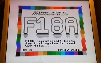

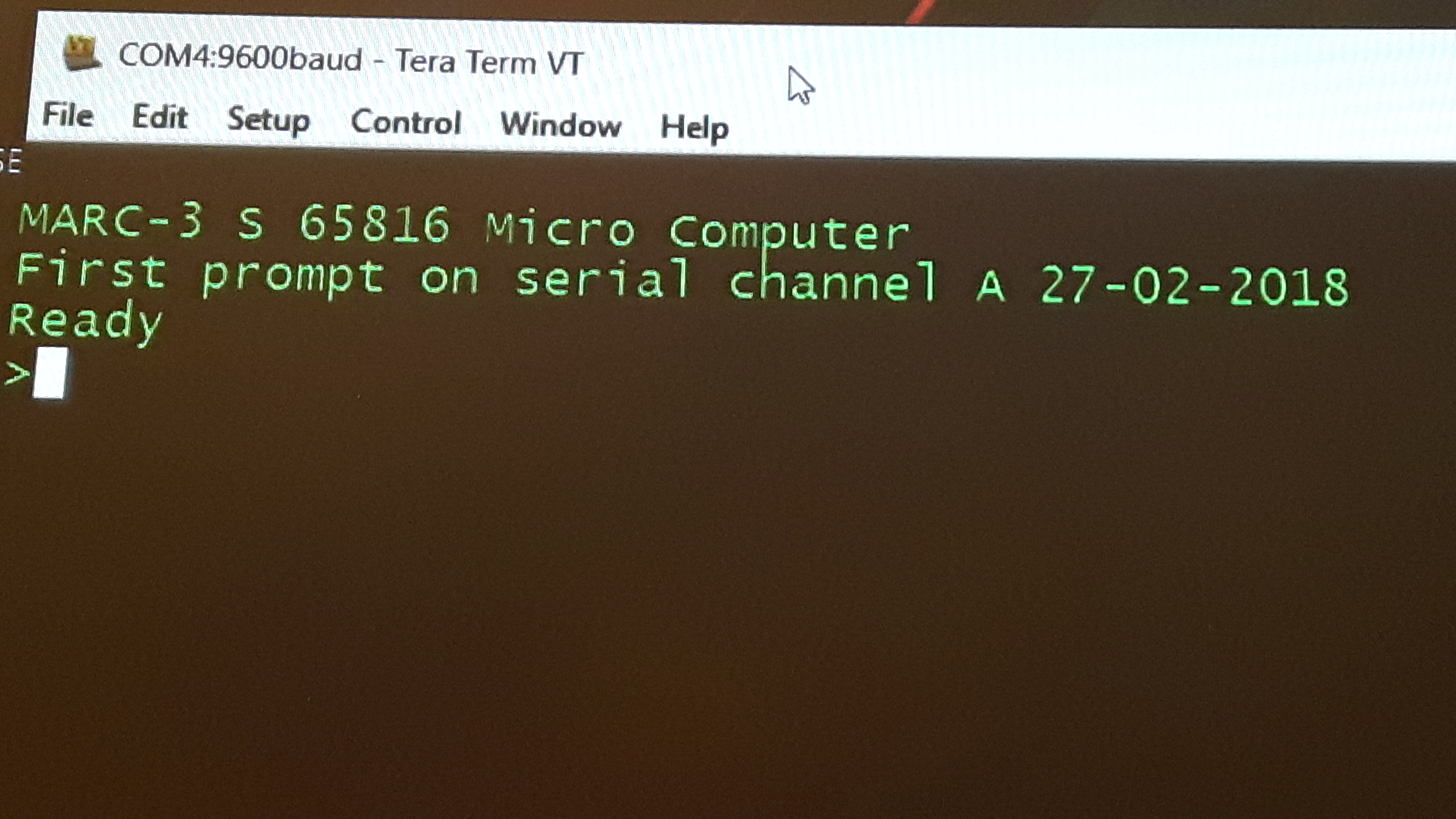

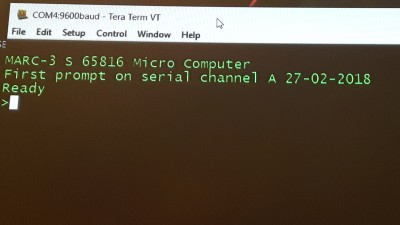

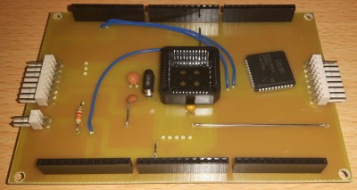

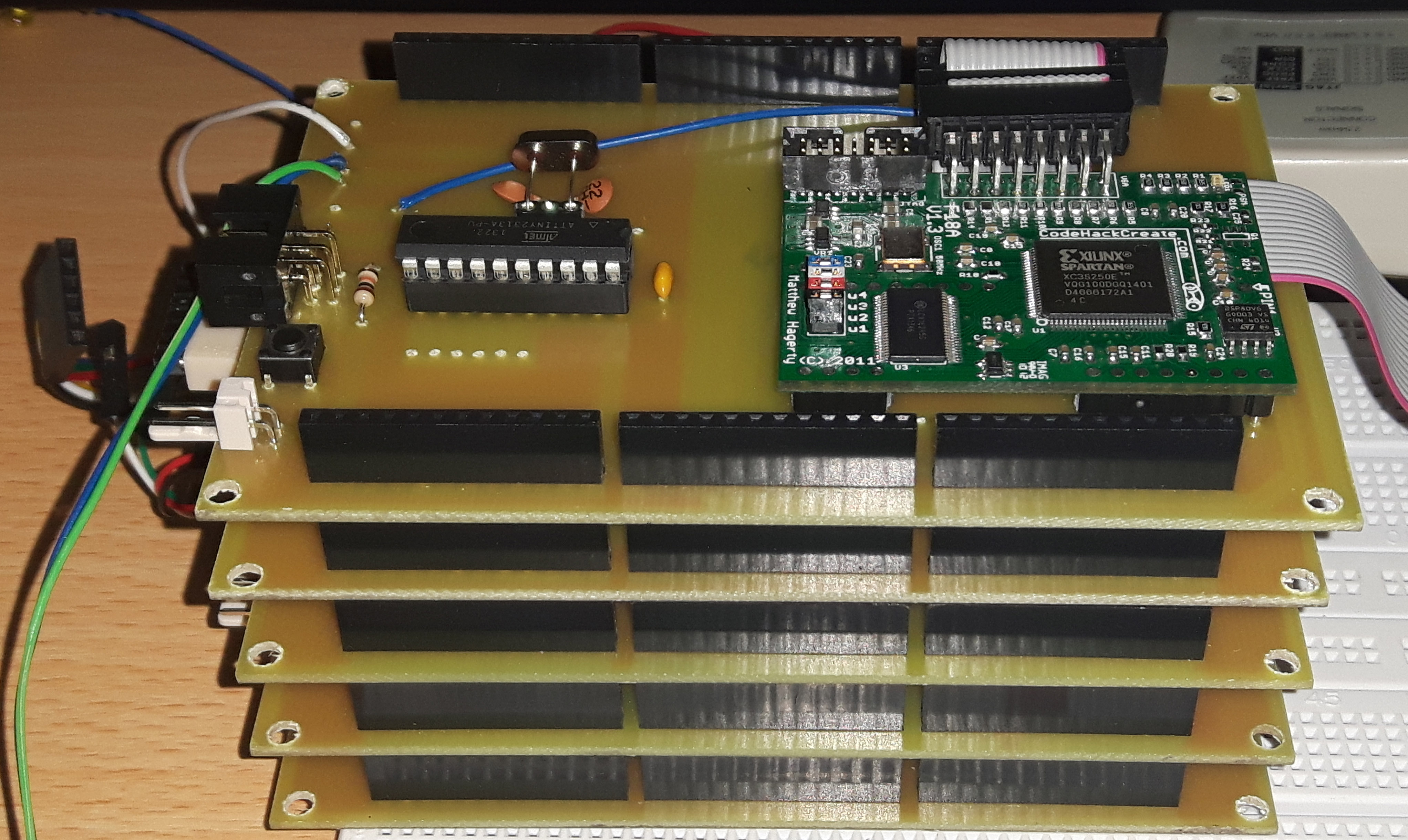

Continuing my build:
After the EEPROM board, I build two new ones, the DUART and CLOCK / RESET boards. Since there was a lot of room left on the CLOCK / RESET board, I added the F18A video FPGA board to it.
DUART:
CLOCK, RESET & F18A:
Does it run CRYSIS? :)
No, but it lives!!!
The F18A isn’t decoded yet in the CPLD, but it starts up correctly and responds to the system reset.
Now I have to tidy up and complete the VHDL code, create a way to easily update my firmware onto MARC-3 S and adapt some software (monitor / ehbasic etc.).
