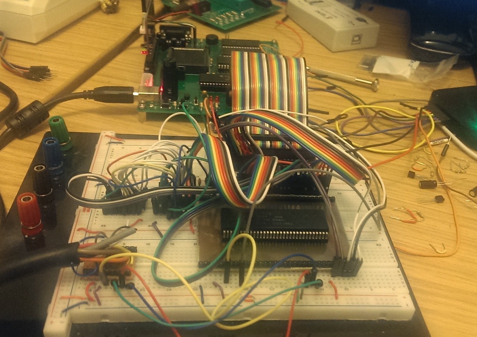

After struggling with this exact same problem for a long time, I opted to move the core of the computer (glue logic, CPU, RAM, ROM, UART) onto a PCB with an expansion header onto breadboards which had the "secondary IO". I used IDC40 cable to link the two halves, since I had a load of headers and sockets.
That photo also shows some other breadboard bodgery I'm rather proud of, including a Shrink DIP adapter.
FWIW I'm convinced you absolutely can run reliable 2MHz (and more) computers spread over dozens of breadboards. It just requires:
:arrow: Very good quality breadboards
:arrow: Decent single core wires
:arrow: Patience to make a very tidy layout
I never really had all three, especially lacking was the last one. Hence I went for the PCB+IO on BB approach.
EDIT: Regarding buffers, I never bothered. I should have but since it worked without them...
