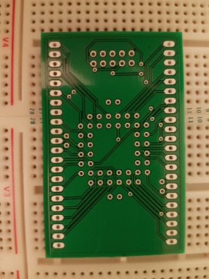

I recently lost track of my DIY adapter which I put together to allow me to program Atmel (Microchip) ATF1504AS CPLDs for my 65C02 projects, so decided to design my own adapter PCB. It's designed to work with my Atmel ATDH1150USB-K, takes a 10 pin JTAG header, has a 44 pin PLCC socket and is 2 layers (keeps the cost down).
The PCB breaks the pins out from the PLCC socket to two 22 pin headers (pins 1 to 44) for testing purposes, routes all 4 VCC pins toegther and all 4 GND pins together and these route to the JTAG header.
I received the PCBs today (ordered 5 to get the cost down and might sell the others if UK folks at interested in buying - cost price only of PCB, components and postage - let me know).
How it turned out:
1) It works :). I soldered it all together, put it in a breadboard, hooked it up and verified the design in an ATF1504AS.
2) It sort of fits in a bread board (if the two 22 pin pin headers are soldered in down wards), but it only just fits with 1 row of holes down each side and it's a squeeze to get wires in due to PCB over lap. I might go for pin headers up on these ones.
3) The pin numbering and VCC/GND pin marking is visible, but a tad too small. If someone has poor eyesight it could well be too difficult to read.
I might get some more made with the following altered, but it's quite expensive to get PCBs made in the UK so I'll have a think on it:
1) Reduce the width of the PCB to allow more room for access to the breadboard holes running down each side
2) Move the 44 pin PLCC socket down and the orientate the JTAG header by 90 degreess so a 10 pin "quick removal" socket can be used (these are too wide for the current design)
Of course, I found my old DIY adapter after I ordered the above (always the way :roll: :lol:). THe forth picture below shows them side by side.
Here're the picys. Any comments/advice welcome (constructive ones only please :P)

PostPosted: Tue Jan 23, 2018 9:52 pm
Posts: 1250
This is really cool. I thought about doing the same thing for the 1508.
The board looks less than 100mm x 100mm. If so, JLCPCB will do 10 of them for $2 USD. Not sure what shipping would be. Have you priced them?

I didn't know about JLCPCB. Have you used them yourself? Seem like an incredibly cheap price - I paid roughly £20-£25 per board (got 5) with 5 days lead time.
Putting in my board stats (40mm x 61mm, 2 layer, 1.6mm thickness FR4, Lead free, No Panel, Green, Qty 5) it says $26 - so much cheaper. My main concern would be the PCBs being held indefinitely in UK customs (had that before with other goods from China :( ) and time in transit. But at $26 it's very tempting...

Got the new PCBs from JLCPCB and am very happy so far :). Soldered components to one and tested: All working fine, the footprint is much better for bread boarding and I can fit a 2x5 IDC ZIF-type socket on for the JTAG connection. The resistor and LED are optional.
Here are a few picys:

So great suggestion with regards using JLCPCB cbmeeks :).

Thanks for the gerber files! I ordered some to test it out for my ATF1504 chips.
Do you have a BOM for the other components?
Daniel
PostPosted: Thu Apr 09, 2020 3:53 am
Joined: Mon Mar 30, 2020 10:20 pm
Posts: 15
0.1uF caps, 220/330 resistor for the LED?
What is that component close to C28?
Daniel
