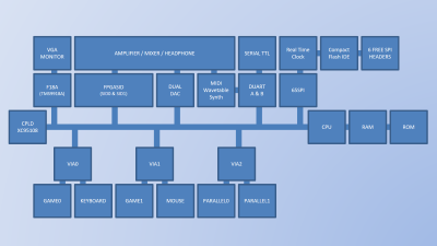

Here is the block diagram for MARC-3 S:
For about 65% of the above mentioned devices / modules I have finished the schematics and PCB layouts, these include the CPU-, CPLD-, RAM-, ROM- and DUART-board. These will be stackable and the basic design for MARC-3 S.
I bought a bunch of 12-pin Arduino headers and 120 x 80 mm single sided copper clads: the build can begin!
Next I’m going to present the CPU-board.

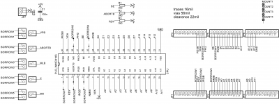

The CPU board:
In the schematic you can see how the headers are organized by the physical layout of the CPU. Most boards won’t need more than a few jumper wires, so that they can be single sided.
I’ve treated the 65816 mystery pins according to this post and Garth’s primer.
However, from the several designs I’ve seen, they all treat them different.
VPB, ABORTB, MLB, E and MX will not (yet) be used. They are all outputs, except for ABORTB, which has a 3k3 pull-up. By means of a jumper, I could tie them to the headers, if needed. Otherwise I could use those header pins for other things, as a last resort if I’d run out of I/O pins on the CPLD.
[edit]
BE, NMIB, RDY, IRQB will initially be pulled high with a weak ‘1’ by the CPLD.
Actually, BE and RDY have external pull-ups.
NMIB and IRQB are set high while not in use.
[/edit]

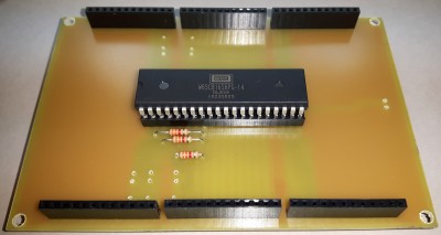

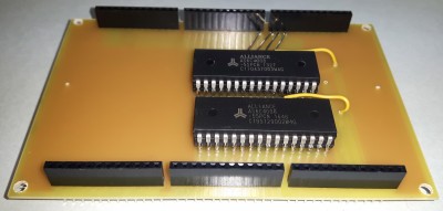

Here's a virgin 65816! :P
Marco

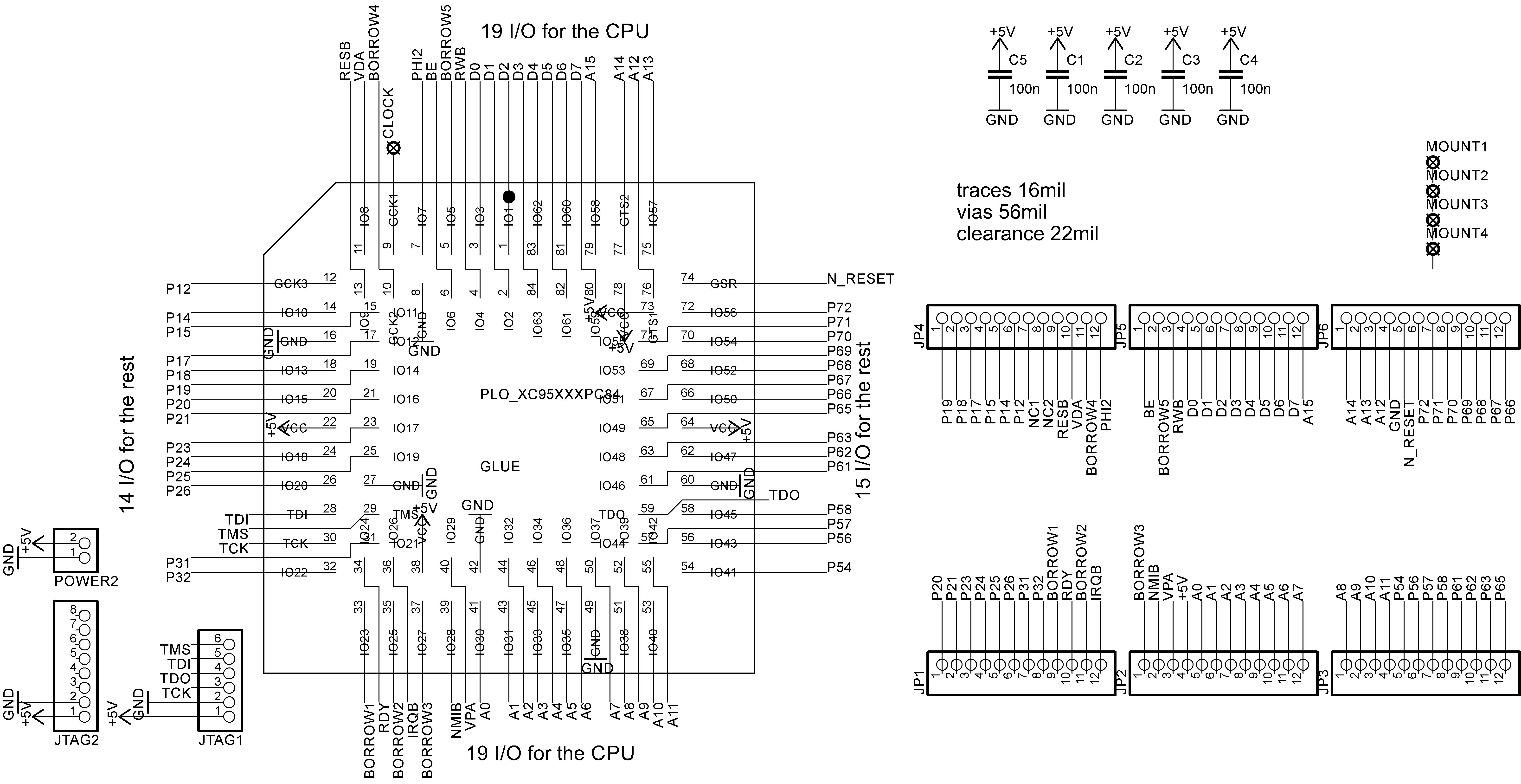

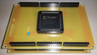

The CPLD board:
As glue logic I’m going to use the XC9572 PLCC84 or the XC95108 PLCC84 if I need more resources. This board is also very straight forward, all I/O pins of the CPLD are connected to the headers, except for the 16MHz clock input, which will come from another source. There are 72 pins in total on the headers, 68 of them are I/O. Two pins are N.C. and the remaining two are +5V and GND. By the way, each board will be connected with a separate power connector, which will provide a more evenly power distribution. A de-bounced reset signal N_RESET, also coming from another source, is added to the headers.
This board is going to provide quite some tasks:
• System clock divider to provide a strong 50% duty cycle PHI2
• SPI External Clock generator
• Reset circuit
• Tri-state various pins during RESET
• UPPER address latch for the ‘816
• Memory read/write qualified with PHI2
• VDA VPA address qualification
• RAM chip selects
• I/O chip selects
• Set 65816 Inputs to defined states
• IRQ handler
• NMI handler

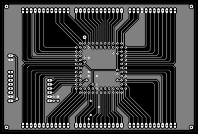

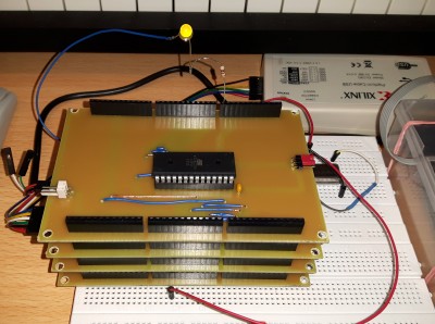

This board needs a few jumper wires for +5V and GND. I had to bring the JTAG connector to the side because of the tight space between the boards. I'll be ordering this kind of connecors.
I've tested the boards for shorts and open circuits, everything seems OK so far.
Next I'm going to test them with a slow clock seperately, and then together...
Marco

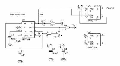

I’ve tested the CPU and CPLD board for shorts and open connections. I’ve also tested the CPU with a free run by setting the data bus to $EA using 10k Ohm resistors. I used a VERY slow clock of about 1 Hz and cranked it up to several kHz and watched the address lines behave like they should.
The clock that I use is an 555 timer astable circuit, eventually I had to add a 74HC74 to get a strong enough clock to make the circuits work perfectly stable. I find this variable slow clock very handy to test the circuit, at least now in the beginning.
For testing the CPLD board, I connected the clock to the first global CPLD clock input and tested all 68 I/O lines individually with a probe. I noticed that the CPLD is even more sensitive for getting a proper clock despite of setting the slew rate of all pins to slow.
Now I stacked the two boards together and want to perform a free run using the CPLD.

The RAM board has two stacks of two 512KiB SRAM’s, making a total of 2MiB.
RAM and EPROM chip select are working fine. Because I have no I/O devices connected to my computer at all, I used a program to test ROM and RAM functionality by checking the address lines going low and high.
At the far end on the bread board there are an ATmega1284P and two 74HC595’s. These are for the ROM emulator, clock and reset. I have prototyped them and the ROM board is in the making.
I guess it's not really a ROM emulator, but more like a RAM programmer. :)

Finally, I’ve got a working system!
The fourth board became a “simple” EEPROM AT28C256 board.
I only decoded it to 0C000-0FFFF.
The CPLD logic does not yet:
• Decodes addresses A16..A18, they are just set to “000”
• Decodes the four SRAM chip selects, they are just set to “1110”
• Do anything with IRQ or NMI, they are both set to “1”
So that’s something to do, but it’s working so far.
