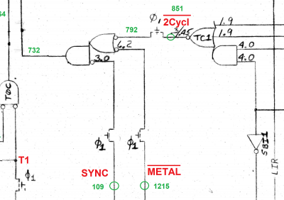

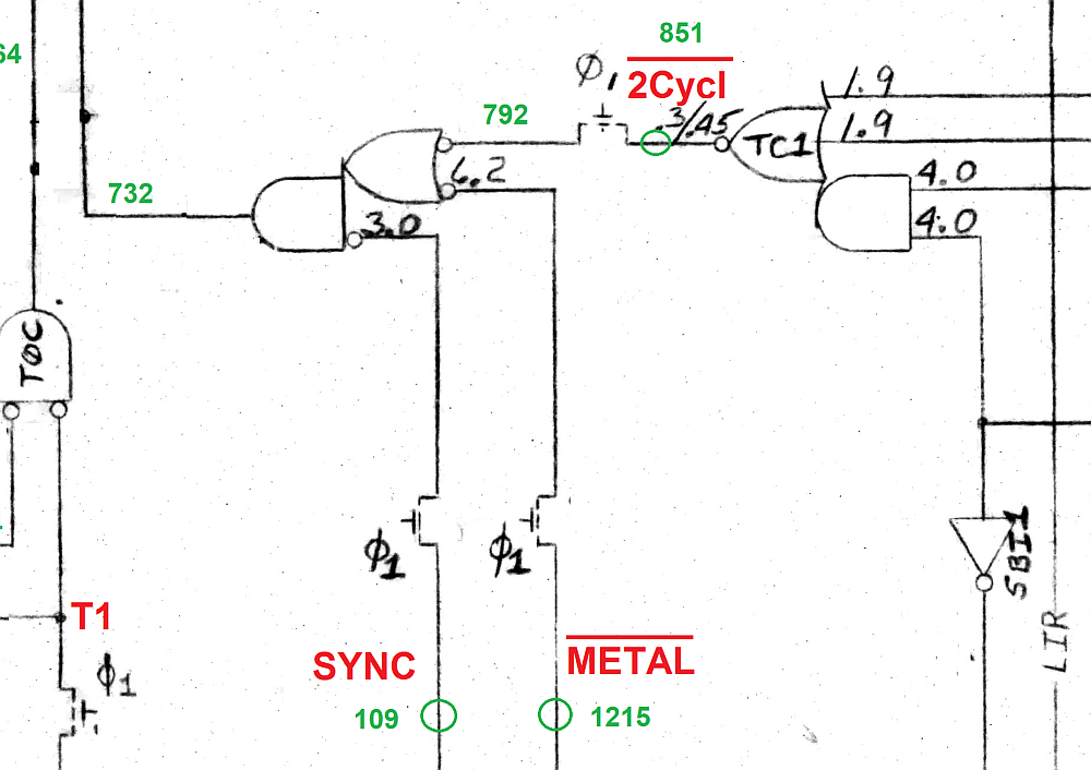

Now I'm sure that TZPRE is the signal on node 792 and PRE is abbreviation for predecoder, hence:
TZERO PREDECODER
I came to this conclusion when looking at this document:
http://www.witwright.com/DonPub/DSH_650 ... erArch.pdf
Herein Hanson's name for the signal #METAL (1357 latched from 1528 at PHI1) is "TZERO" (see page 7 top) and he
describes it's usage in the T2-T5 shift register: "... TZERO is a clear signal ..."
This signal is OR'ed with signal from node 792 (#TZPRE) which perfectly explains it's usage:
If either TZERO (aka. #METAL) or #TZPRE is asserted the next state is T0 or T0+T2.

Good detective work!

My thanks too, for determining TZPRE. I was also wondering what it mapped to in visual6502.
I have an additional 2 cents about its naming. In visual6502, node 792 has a name of ~TWOCYCLE.phi1 in the nodenames section. This also supports the conclusion of it being the TZPRE signal, as it has its origin inside the predecode complex (the node named ~TWOCYCLE), and it plugs into controlling the clock.
Continuing to narrate its effect upon the clock (thinking out loud):
So... TZPRE is low for the two-cycle instructions, and that disconnects node 732 from being (indirectly) grounded by node 1528. Background for thoroughness: 732 ungrounded results in the T0 clock node becoming active (low). The disconnection feature allows the T0 and T2 clock bits (nodes) to the PLA to coexist in their active states (explaining that clock state), and giving us T0 earlier than normal. Ordinarily we would have T2 by itself and T0 in the next cycle.
For the two cycle instructions, the normal initiation of clock reset to T0 by the PLA is insufficient: the earliest opportunity by PLA is at T2. To compress operations down to one cycle between fetch cycles, the signal initiation has to be done one cycle earlier than T2, during the fetch cycle. Thus predecode originates it.
For non-two-cycle instructions, TZPRE is high. The clock can only be set to its T0 state by node 1528 itself being grounded (by another signal), allowing 732 to be ungrounded that way.
End of thinking aloud.
So now we understand this in terms of what originates clock reset to T0: predecode for 2 cycle instructions, and PLA for all others. The former initiates T0 without disturbing the rest of the clock state in progress.
Thanks again, and thanks for inspiring this romp.

An afterthought: the mention of TZPRE in Dr. Hanson's diagram really needs a horizontal negation bar over it to indicate active low.
