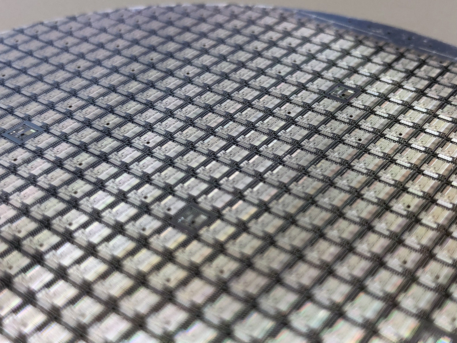

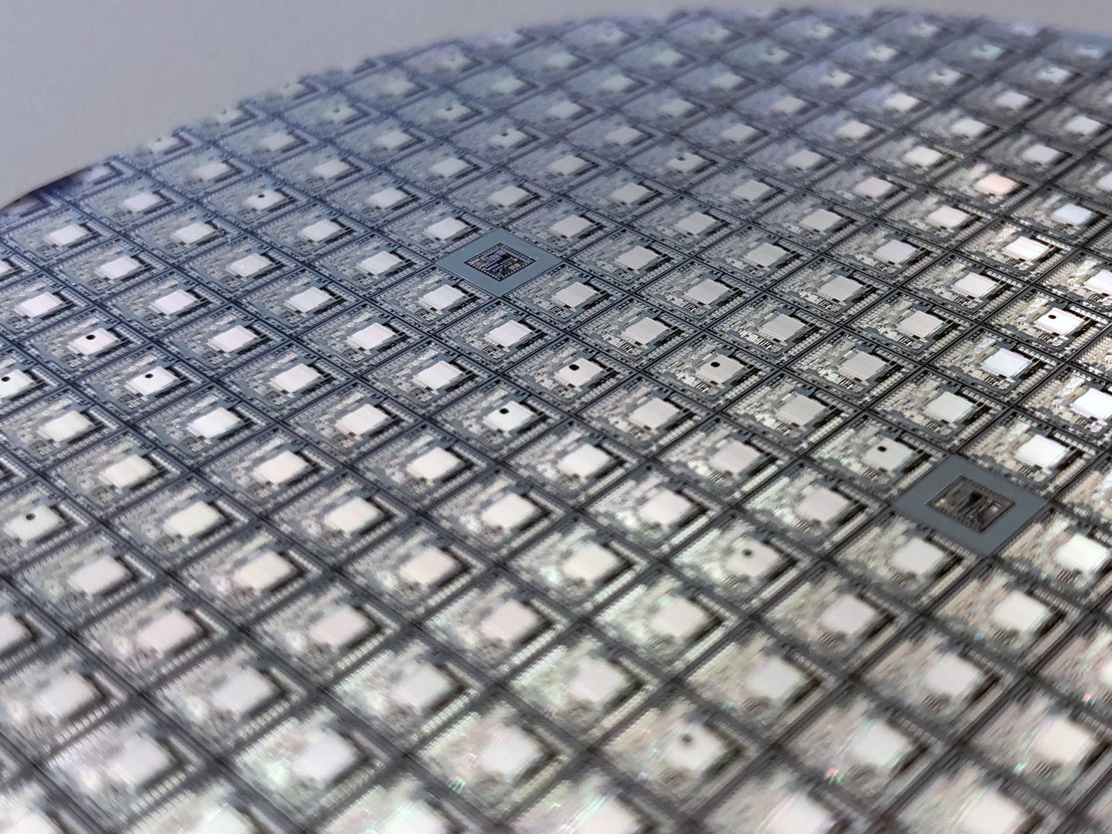

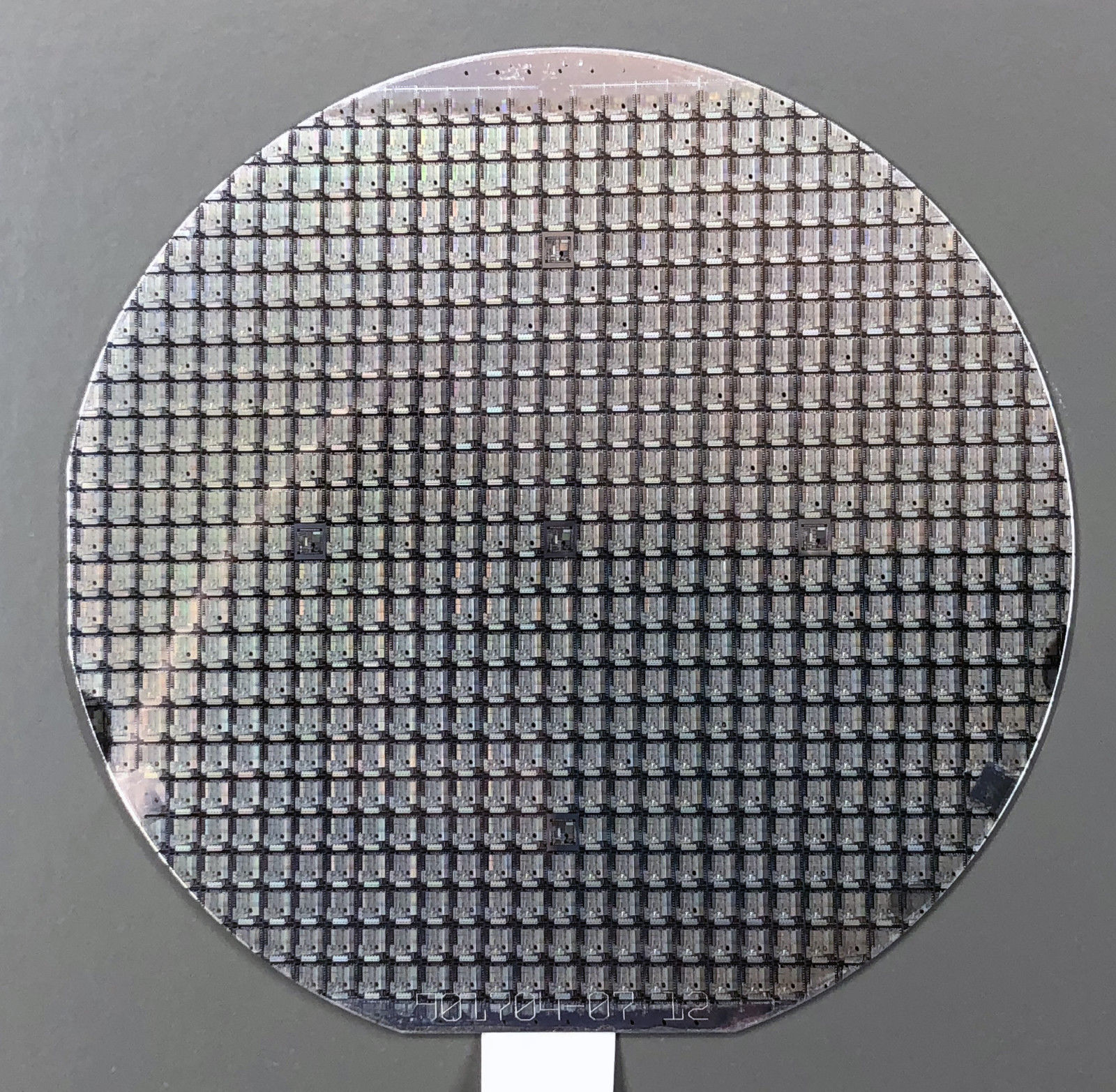

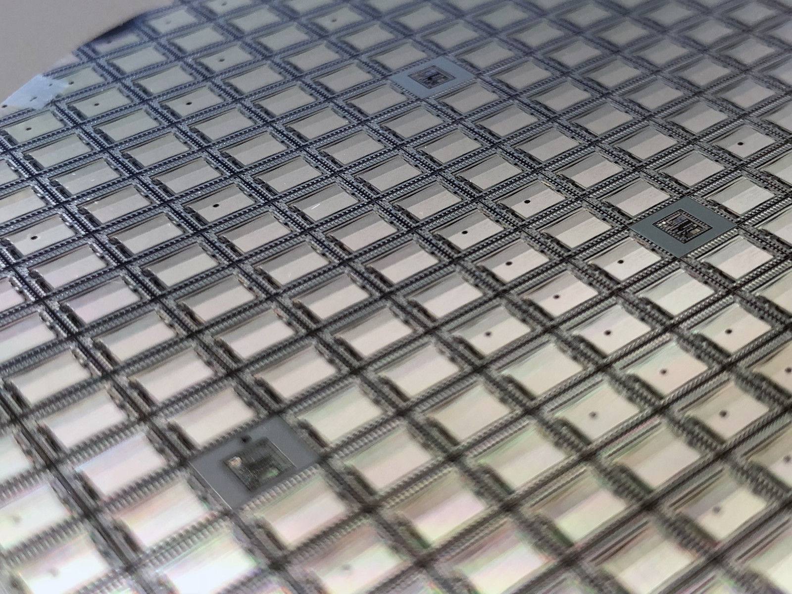

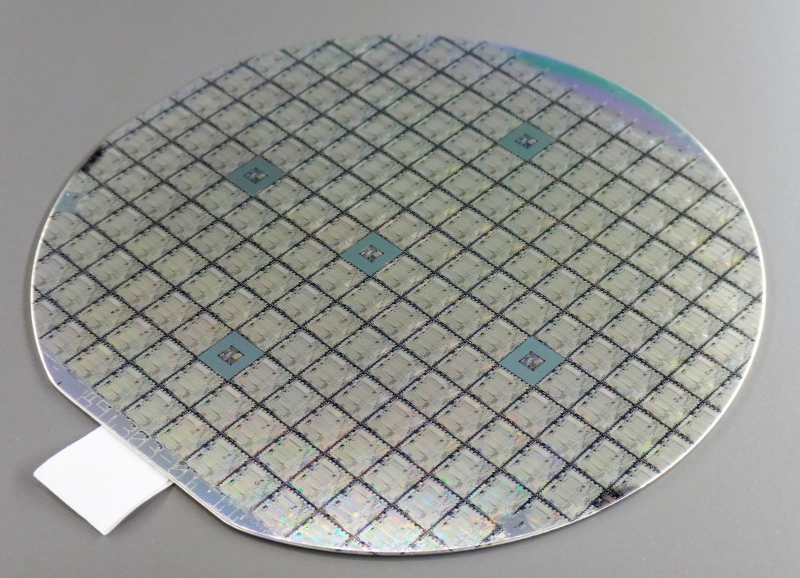

Well, just to follow this up a little bit. I recently bought a 6569R5 wafer from someone on ebay. It is a full 4 inc/100 mm (pick your choice) wafer with 6569R5 chips. I am not sure if some of them are marked (bad ones), so this may have came out from before device testing. There is also 5 smaller chips on it, which are probably a test run of some other component. It looks like it has been decently stored.
The 4 inc wafer is the reason Commodore made very little money. Compared to 6 inc process, 4 inc was much more expensive per chip to run. A contemporary report from Intel shows this really well. Looking at the wafer we can see that its only about 250 chips on them as the 6569 is quite large.
I also include some other wafer pictures from MOS. All made in 1984 or later on 4 inc. In fact, one (dma controller) seems to be an Amiga component used in the A2090 scsi controller which was sold from 1988.
All-in-all this seems to indicate that Commodore stuck to their 4 inc process into the late 1988. Not surprising since they had little money at the time, and it looks like they neither put capital aside to replace the fading 4 inc process.
MOS 6569R5 VIC-II:
File comment: MOS 6569R5 VIC-II
MOS 6525R3 TRI-PORT interface (confirmed by seller that this is not the 6526, but the 6525):
MOS 8721R3 PLA
MOS 8727R3 DMA
