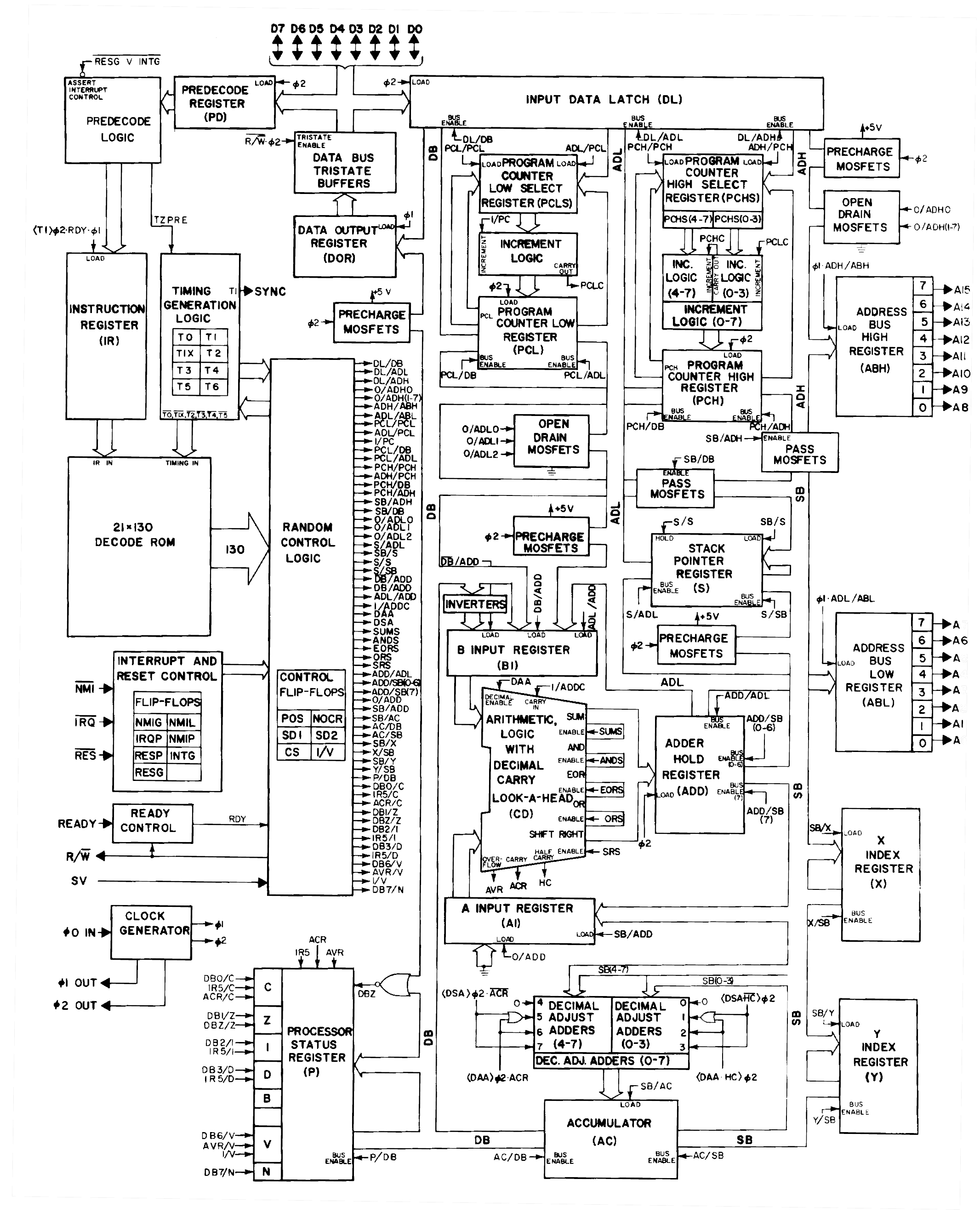

What about this diagram?
This is an updated version of the 6502 CPU.
It was decapped, photo taken and block
diagram drawn.
Can anyone read this?

muchtolearn: that's Donald Hanson's well-known diagram. Follow the breadcrumbs and it will lead you to Michael Steil's blog, and repository, and talks on YouTube. It will also lead you to the visual6502 wiki.
Any web search engine will get you from any of the phrases you are quoting to the source material. You should follow those breadcrumbs too, and do some reading.

then I remembered that Ken Sherriff had de-capped a 6502 and
Take a die photo. So I emailed him asking if thee was an updated schematic and he
gave me the pagetable.com link. Hence the block diagram I uploaded. Which leads to you comment about hence do some reading. I read quite a lot and have read many books of 6502, computers and assembly language. if the block diagram is more upto date then books written in 70's and 80's, then it makes it more informative. Gee, I don't know, we might learn some new information or get clarification of what had been written or missing parts we didn't know about the CPU filled in.
