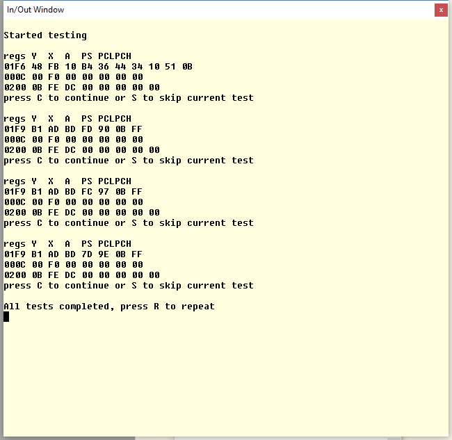

Just discovered that the BRK instruction behaves differently between 6502 and 65C02 mode of the simulator.
6502 mode:
In 6502 mode you get the known bug where the processor status pushed by the BRK to the stack at $1fd ($10) has the break bit set but not the unused bit. The other 3 errors are from the second pass with interrupt disable and indicate that the interrupt handler has not modified any of the registers A, X or Y.

PostPosted: Mon Dec 04, 2017 8:59 pm
Posts: 1747
Location: Sacramento, CA
Hi Klaus,
I found the PHP command was not setting the BREAK bit or the unused bit in 65C02 mode. I have fixed that. I will check the RTI again since it may be fixed with the BRK and PHP mods. I'm almost finished with bug fixes.... I've been stuck on 1 small artifact of simulating the unused opcodes. I ran your test suite yesterday and both 6502 and 65c02 tests passed. Once you get your mods posted, I'll re-run them.
