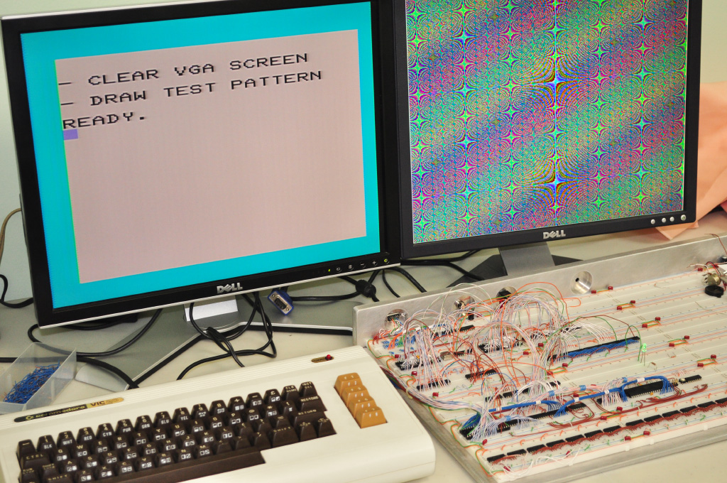

I realize it's been a while since I posted any updates on this project.
The project is still very active, but it has "evolved" somewhat.
Everything up to this point was mainly testing on the Audio and Video Hardware, and I have finally settled on the general design, which is 400 x 600 resolution with 4096 simultaneous colors.
I have also had the chance to test the 65C02 IO decoding system, which worked very well. So I now have a powerful 6502 powered computer system built with nothing but 1980's era logic gates and simple static RAM.
The challenge now became... how do I develop code, assemble, save, and load?
The original idea was to just drop in a PS2 keyboard and SD card, or some kind of USB host chip like the Vinculum II.
Something about relying on modern hardware didn't feel right to me.
It would be like dropping a 57 Chevy on top of an Impala frame... not my kind of Hotrod!

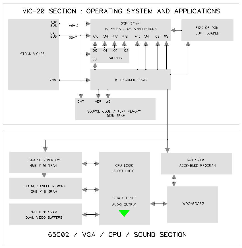

So I have recently rediscovered my favorite computer of all time, The Immortal VIC-20!
I have decided to rename the Vulcan-74 System to The VIC-2000 Expansion System.
This entire system will become an Expansion Cartridge for my stock VIC-20!
The VIC will handle the Operating System and IDE / Assembler, and the 65C02 on the board will run the code, talking directly to the logic board. This way, I am staying "retro", and can start to enjoy the first computer I ever owned again. The VIC will remain completely stock, and talk to the new hardware only through the Expansion Port. All 6502 code will be developed on the VIC-20 screen, and the 65C02 on the board will display its output from the assembled code on a separate VGA monitor. Yep, dual display VIC-20 in charge of 16MB of SRAM!
Because of this course alteration, I have continued my build log over at the VIC-20 forum "Denial" here...
http://sleepingelephant.com/ipw-web/bul ... =11&t=8734
I'm sure some of you are members there as well, and it is a great wealth of VIC-20 knowledge for me.
This entire project will be re-posted on my own site in much greater detail when it is done "some year", but for now you can continue following the trials and tribulation on the link above.

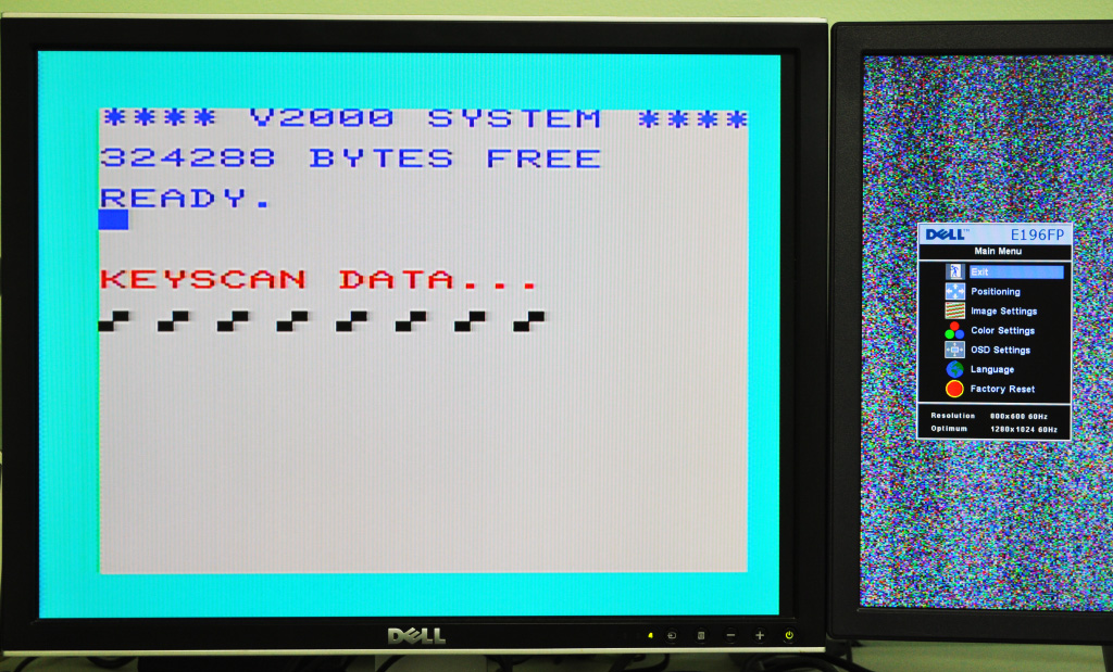

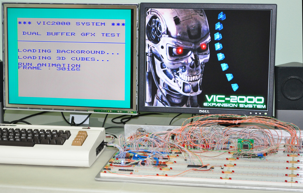

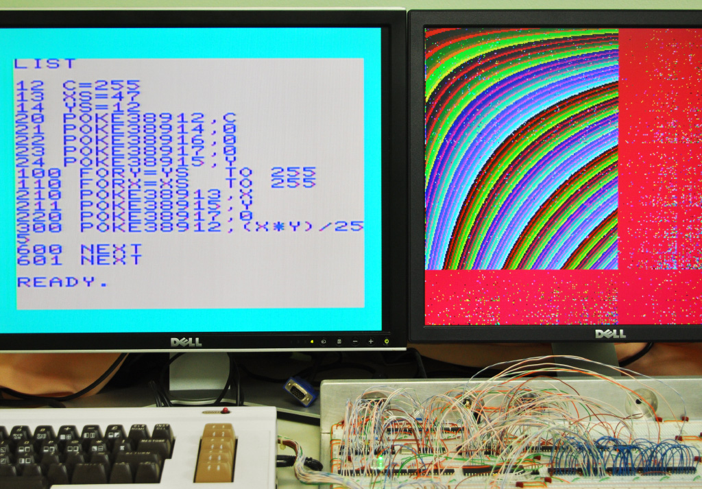

Here are some highlights as I reacquaint myself with the inner workings of the VIC-20...
VIC-20 Draws 400 x 300 color bars in Basic.
Initializing the SyncGen Hardware and Code Memory.
Quick video showing the test setup...
https://youtu.be/R1eGVoCmE5k
VIC-20 (top section) merges with Vulcan-74 (lower section).

The reason I decided to attach the entire system to the VIC-20 expansion port is to allow all 6502 coding to be done on an age appropriate platform. The 6502 / Logic based GPU system will still be blazing fast, but I will be coding and assembling on a 1981 computer rather than some cheaply made PC of the day!
The Vulcan core has actually grown up a bit as well, and now features a 12 bit color data bus as well as increased VGA resolution. I still have a few years of development to go, but have at least settled on the final specs and goals.
I also intend to install a secondary 65C02 in this system so that the VIC-20 has a companion processor!

I finally broke the 640 x 480 x 4096 barrier!!!
This is something I have wanted to do (and tried) since day one of this project.
At 25MHz and 16 bits of data, it almost seemed that I hit the breadboard barrier.
But last night and a total rewire (again), I finally did it.
Totally stable all the way.

Hey, look what my VIC-20 drew today!...
