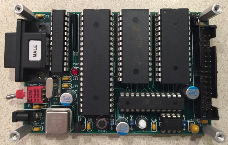

... to a new SBC that is :D
After a 3-year delay, I now have a new Pocket SBC completed and running. While there's nothing truly earth-shattering about it, it does provide a new development platform with good flexibility with a fair amount of function that fits in your shirt pocket.
Specifications:
- W65C02S running at 6MHz
- 32KB SRAM (Alliance 62256 @ 70ns)
- 32KB EEPROM (Atmel AT28C256 @ 150ns)
- Single glue chip (Atmel ATF22V10C)
- Single Reset chip (TL-7705B)
- Panic/NMI debounce (Maxim DS-1813)
- UART (NXP/Philips SCC2691)
- FTDI D5-USB-5M UART to USB interface
- 30-pin Bus expansion connector
- 4 I/O selects on the bus that are 32-bytes wide
As I had quite a lot of the required chips, sockets, caps, etc., I opted to use all DIP packages. I wanted the tiny size and used ExpressPCB's MiniBoard Pro 4-layer option, i.e., 3 boards for $81. I managed to squeeze everything in and get down to 349 through holes (350 is the limit) by breaking a few design rules for horizontal and vertical traces ;-)
For me, it's been a fun little project and provided the following new bits:
- Using a new Reset chip that provides Positive and Negative leading Reset lines that are open collector/drain.
- Using a PLD device for a single glue chip (provides ROM/RAM and 5- I/O selects plus MWR/MRD lines).
- NXP SCC2691 UART to get off of the ailing 65C51 ACIA for a console.
I have to say that getting the 2691 UART running was a bit painful. Documentation is somewhat lacking and the actual initialization process is quite extensive compared to the 65C51. As it stands now, I have an early BIOS working with a slightly modified Monitor from my previous board set. It still needs some work, but the UART is functioning in a stable manner and am also using the Timer/Counter as a Jiffy Clock (10ms) for keeping time and providing accurate software delays via the Monitor.
A couple pics:

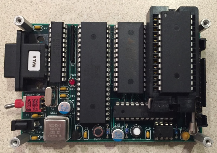

Second pic with a ZIF socket stepped up in the EEPROM socket for easy swapping.
I'm hoping to get most of the BIOS/Monitor completed by end of the year and then start adding some new features (to the BIOS/Monitor) and hopefully add in MS Basic as well.
Three years isn't bad. I started design work on POC V2 in 2010 and didn't have assembled hardware until the latter part of 2016.
It seems as though NXP did a little better job of documenting the new UARTs—the 2691 is nearly 30 years old and its documentation is kind of lame. All NXP UARTs are highly configurable, which means you have to do a fair amount of setup and initialization to get them running. It's kind of like starting up an old airplane with radial engines.
 A couple pics:
The way your chips jammed together kind of resembles the Hong Kong skyline. :D

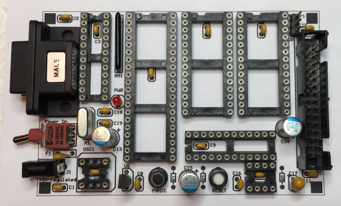

Haha... thanks. It's also has some smaller nested buildings, i.e., the bypass caps. I opted to hide them under the chips as the sockets provide ample space and it allows them to be close to the power pins.
I also printed the top layer out to ensure parts would fit. Despite close neighbors, the chips can still be pulled quite easily.
I used a small piece of styrofoam, placed the 1:1 paper printout on it, used a small sharpened point to poke holes for all of the components and popped them in to ensure proper fit and spacing.

Paper and foam - that's a nice technique!
349 squeaky pops in Styrofoam. My teeth are literally grinding thinking about that...must have been unpleasant to say the least!

- paper and styrofoam as a technique... Never really gave it much thought, just seemed logical with all of this stuff sitting around the house. It worked out better than I expected.
- poking 349 holes... no real issue as I only poked the holes through the paper, I use the component leads to push into the styrofoam. It really didn't take much time actually. I ended up doing about 3 minor layout changes, so I did this print and poke thing a few times before I was happy with it.

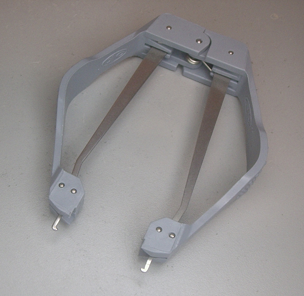

I am thinking my next SBC project will be based on a NXP DUART and all main packages (CPU, GLUE, EEPROM, DUART) will be in PLCC.
Even in sockets, PLCC parts use less PCB real estate than DIP equivalents. Thanks to PLCC parts, I was able to cram POC V2 into almost the same sized board as POC V1, even though V2 has a lot more RAM, more RS-232 channels, etc. Only the expansion port and the ROM socket are DIP.
If your PLCC devices are socketed you can readily remove them with a chip puller.
File comment: PLCC Chip Puller
