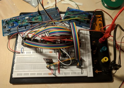

Hi all! I've been lurking for a while, but I think it's time to get involved.
This is my first step in to the homebrew computing world, and having devoured Garth Wilson's legendary site pretty much in its entirety and appreciated a fair few of Jeff Laughton's articles as well, I've arrived at the following fairly modest goals for my first build:
- WDC 65C02 (well d'uh, I'd be in the wrong place otherwise!) @ 2MHz
- 8k ROM
- 48k SRAM
- Rockwell 65C52 DUART, driving pin headers which allow me to plug in FTDI dev board clones (https://www.sparkfun.com/products/retired/8772)
And that's about it. Not even any GPIO.
I've attached a PDF of my proposed schematic, and I'd really appreciate it if any of the helpful folk who frequent here could cast an eye over it and comment on whether it makes sense.
I've got it more or less running on some breadboards (with several deviations from what I propose here - address decode, reset and clock are all different!), but I haven't exactly pushed it (it writes "Hello World" in response to each character sent to the serial port), but a PCB of this size will be a somewhat larger investment than I've made to this point. While I know that mistakes are almost inevitable, I'd like to do everything I can to get it right!
Once I've demonstrated to myself that I can get this rather simple system up, I have a whole host of aims for future revisions. I've been playing with an FPGA which could be used to implement a graphic card, for example (even with some modest success!). And I might also move on to implementing something with a more challenging processor (probably the m68k of my childhood best friend, the A500+).
Then there are the crazy ideas. I recently came in to possession of a 90s vintage PSTN gateway, for example, and harvested from it no less than 9 (count em!) 80186 processors. Anyone fancy exploring bus arbitration logic in a multi-processor system with me somewhere down the line? ;)
As this is my first post, it also seems like a good moment to thank the people here for the level of insight I've already gleaned from their personal sites and the archives, even without ever asking a question. This place has been a fantastic primer in digital logic and related subjects since I made it a hobby a few months ago, and the willingness of people here to help those new to the subject without judgement or condensation is really quite inspiring!
Mike
File comment: The breadboarded monster, with reset/clock and address decoding on their own protoboards, top-left and top-right respectively.
File comment: Proposed schematic
schematic.pdf [104.12 KiB]
Downloaded 168 times

A little backstory on the excessive looking protoboards...
The address decoding was done with a three deep combination of 74HC00 and 32 (nand and or), which I propose to replace with a 74138 and a single 7400. I don't think it will improve the prop delay (in fact, it's probably marginally worse), but it feel cleaner. I thought I'd eliminated some chips, but actually, since I scaled back my ambitions to a single IO chip, this appears no longer to be the case.
The top left board houses a reset conditioning circuit, which is over-engineered to produce a short pulse, but I've removed that because my 65C02 won't overheat. And clean pulse is fine, regardless of length.
It also has the clock generation circuit with a toggle switch to select between the crystal and a single cycle button, using some tri-state buffers to gate the final clock signal. However, I've discovered that I can't use the switch while the machine is running without adding some flip-flops in to the mix to prevent the machine crashing when the crystal output is cut mid-cycle and the minimum cycle time is violated. So I've pared that back for my first iteration as well.

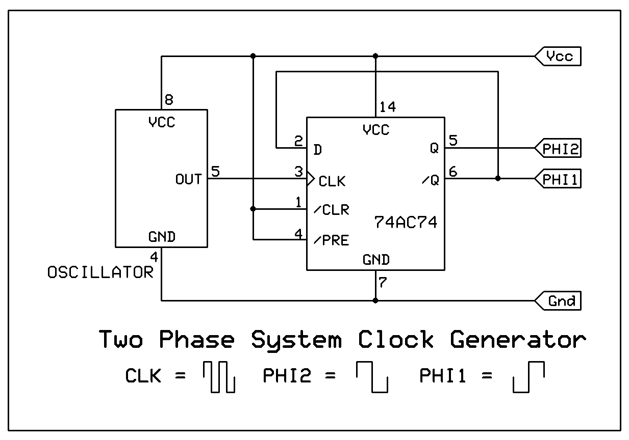

I looked over your schematic and have the following comments.
  1. As Alarm Siren indirectly noted, MPU inputs cannot be allowed to float. Inputs that are not positively driven by another device should be pulled up to Vcc, preferably through 3.3K resistors.
    Do not directly connect RDY to Vcc. If RDY is directly connected to Vcc and a WAI instruction is accidentally or intentionally executed, the 65C02 will attempt to pull RDY low, which would effectively result in the MPU trying to short out your power source.
  2. Per WDC's recommendations, the PHI1OUT and PHI2OUT outputs should not be used and should be left unconnected. All system timing should be derived directly from the Ø2 clock generator circuit. As Alarm Siren pointed out, WDC does not test PHI1OUT and PHI2OUT, and does not specify how much those signals lag the Ø2 clock generator.
  3. In the future, I recommend you use a "can" oscillator to generate your Ø2 clock. A half-can oscillator takes up little space on the board (much less space than a crystal and the components that go with it), costs little more than a "bare" crystal, has better fan-out, and will generally be more stable. The can oscillator's manufacturer has done the work for you in achieving stability and reliable operation over the operating temperature range. A home-grown oscillator circuit may not always perform as expected.
    In my designs, I pass the oscillator's output through a flip-flop to strengthen the waveform and make it perfectly symmetric. The WDC 65C02 is somewhat fussy about clock quality and at higher speeds, asymmetry can result in timing violations. If you do that, you will be using an oscillator whose frequency is twice that of the desired Ø2 frequency. The following illustration is a typical circuit.
    File comment: Clock Generator Circuit
    At the relatively low speed at which your circuit will operate you can ignore the use of the flop and directly connect the oscillator's output to the MPU, as well as to other hardware that needs the clock.
