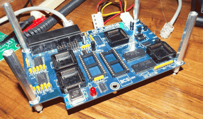

Progress has been slow on POC V2.1 as of late. The SMD stuff was soldered to the PCB back in June, but the unit had to collect dust until now as I again underwent more treatment of my left eye. Vision has slightly improved, enough so that I was able to resume some electronics bench work.
File comment: POC V2.1, partially assembled.
In the above photo, the partially completed unit is being checked for basic power distribution after undergoing an ohmmeter check for egregious faults. This was also a check for proper operation of the reset circuits. Proper voltages appear at all four serial ports, which means the two MAX-238 transceivers are alive and I correctly installed all the tantalum charge pump capacitors. :shock: So far, so good.
Installed active devices in the above photo are the two 512K SRAMs (near bottom right), two MAX-238 transceivers (left), a NAND gate being used as an inverter (near bottom left), the IRQ AND gate (immediately above the left hand DIP socket), the UARTs' X1 clock generator (bottom left) and the two Maxim DS1813 reset generators (right side above MPU socket), one of which is used to dampen the NMI circuit. I see a response when I manually negate each of the IRQ AND gate inputs, as well as the NMI circuit, so I'm good there.
Remaining assembly work is to install all the bypass capacitors, and the 10 pin JTAG port header, which I forgot to order along with the other parts.

POC V2.1 is fully assembled and passes all preliminary checks. Remaining are programming the CPLD and writing test code to see if the hardware works. Then will come time to see if she goes or blows. :D
Thinks got delayed some more due to a little medical problem that popped up on October 30, necessitating a stay in the hospital. I'm back home and have resumed on POC V2. The CPLD has been programmed through the onboard JTAG port, a test ROM (version 0.0.0) has been burned and a test run has been conducted for signs of life.
The ROM is programmed to act as a NOP generator. At reset, the ROM is mapped in from $00E000-$00FFFFF. So I merely assembled a bunch of $EA bytes from $00E000-$00FFDB. At $00FFDC is JMP $E000. The hardware reset vector points to $E000, causing the 65C816 run a gazilion NOPs, jump back to $E000, and around-and-around we go. Very simple and capable of simultaneously proving several circuit functions.
I placed a logic probe on the /RD (read data) line, ducked under the bench and flipped the switch (actually, I didn't duck—I'm fearless when it comes to five volts).

As soon as the MPU came out of reset the logic probe started showing activity, which meant /RD was being pulsed. The logic for /RD is RWB && Ø2, so that meant the MPU had to be reading instructions from somewhere.
File comment: Logic Probe Showing System Activity
A check of pin 20 on the ROM, which is /CE, showed activity. The /CEs of the DUARTs and SRAMS were all high, as were the expansion socket's I/O select pins. Based upon that, my conclusion is the core CPLD device select logic is working and instructions are coming from ROM.
I also checked a number of other control signals and could see what appeared to be proper activity, especially /RDY, which should be cycling due to ROM accesses being wait-stated.
Given what I've seen so far, it appears the POC V2.1 is functional at a basic level. In other words, she goes and didn't blow. :D Next step will be to create ROM version 0.1.0, which will determine if the console display can be written and read.

The above runs a endlessly runs gazillion NOPs, as the first ROM did, but entirely in RAM. During testing, I monitored A0 and RDY. As soon as the MPU jumped into RAM RDY stayed high, which it is supposed to do. So it looks like it works.
File comment: Set Up to Test from RAM
File comment: Monitoring A0 Line
File comment: Monitoring RDY
