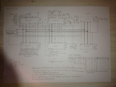

EDIT 14/10/2017: Added current circuit diagram and a few photos.

BTW: that three pin connector at the /WE input of the ROM...
If you would be pulling the jumper with the computer powered on, /WE of the ROM might be floating, sensing LOW by accident.
Maybe it would be better to have a 10kOhm pullup resistor or such between ROM /WE and VCC and to use a two pin jumper instead.

That DC-DC converter looks like it's exactly what I want. Thank you for pointing it out to me.
I don't remember having ever pulled the write-protect jumper before... Not that that makes your point any less valid. It probably won't be in the final design, at least, not in that form. I might adapt your idea, and have a two-pin jumper controlling an input to some sort of logic that determines whether or not it gets written to. Then you'd pull it out before you write to the ROM, and put it back after.

I've got a bit of an update on the project. I finally got around to finishing the KiCAD schematic. Since I'm not planning on doing anything unconventional, I ran it through the ERC, and I've gotten large numbers of warnings, all saying that pins on the buses aren't connected to anything, or otherwise aren't being driven. I believe that I may have run into an oddity in KiCAD, as what it's saying appears to mean that the buses are all disconnected from each other.
I haven't looked at the netlist yet, and I'll do so shortly. I might be able to edit it manually.
Has anyone else made this work?

I think I've completed most of the PCB layout now, but since this is the first board I've laid out, I'm not sure of my work. I kind of expect what I have to be a bit of a bog's breakfast, and I know that getting PCBs made is not real cheap, so I don't want to mess up.
I hope I'm not asking too much, but could someone more experienced than me take a quick glance at these, and see if I've done a stupid?
I've attached the gerbers of what I have so far. I hope the fact that I zipped them up isn't going to be too inconvenient.

I've been meaning to reply to this topic for some time, since the idea excites me.
As far as constructive criticism goes: You have .016" vias and it looks like their pads are about .0235". For reliability, you need a wider ring around the hole. You have way more than enough room (I call it the "moat" [Edit: I found out the industry calls them "antipads"]) around the pads anyway between them and the edge of the holes in the planes, so go ahead and enlarge the via pads a bit. Remember the board house has to drill the hole a little bigger initially to end up with the final size per the spec after adding the plate-thru. I always make the via pad size .020" larger than the finished hole size. With a good board house, you probably don't need that much anymore; but for the low-cost hobbyist board suppliers, the accuracy isn't always as good (I speak from experience), and if the hole is off center, you might end up with no annular ring connected to the trace, and the trace just falls down into the hole, leading to less reliability, like if there's a crack right there at the corner and you lose the connection.
For low-cost boards, check out http://dev.dirtypcbs.com/store/pcbs . As far as I can tell, this is part of one of our favorite hacker/maker sites (I can't remember the name of it [Edit: It's "dangerous prototypes"]) and they use several board houses, and which one they give your job depends on what's in it. If you're concerned about cost though, making it denser, ie, putting the parts closer together so you can make making the board a lot smaller will definitely save money. The smaller size is definitely appropriate for a hand-held unit anyway. For DIP pins, I use a .030" hole and pads .050" wide, which makes it easy to get two traces between pads at .010" trace/space, or even three at .007". You won't have to pay extra for narrow traces until you get below .006" trace/space.
