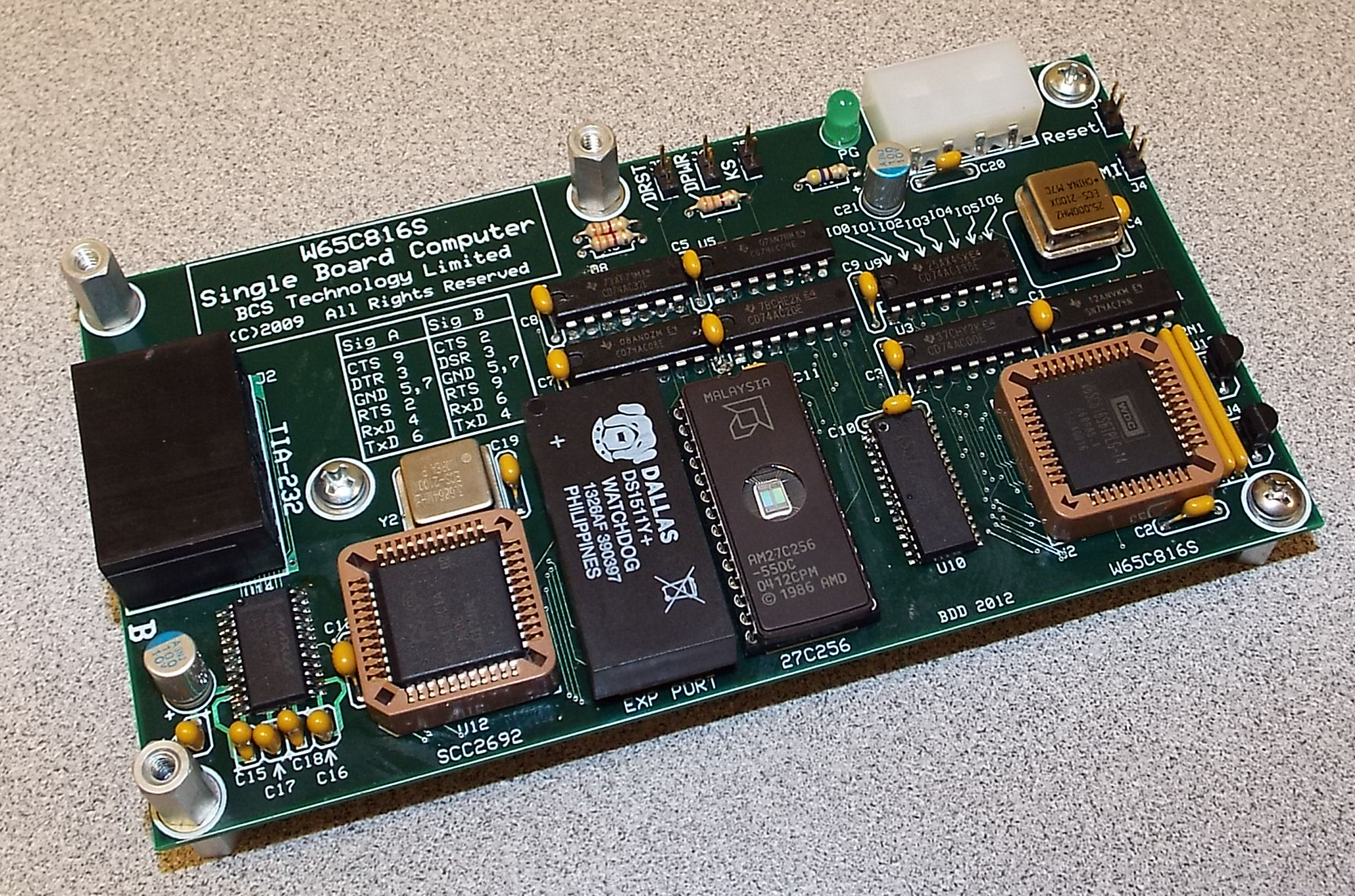

I used an SOJ32 SRAM in POC V1 and manually soldered it.
File comment: POC V1 w/SOJ32 SRAM
POC V1 also has an SOIC24 package. which is near the left end of the board.

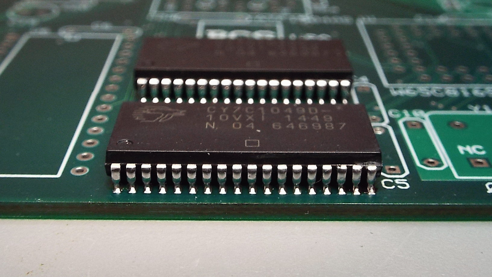

Garth's 4MB DIMM is built up from SOJ36 SRAMs, which he manually solders. POC V2 has two SOJ36 SRAMs that were manually soldered.
File comment: SOJ36 Manually-Soldered SRAM

except, soldering TSOP must be easier because you can get to the leads, and with SOJ you can't. I think Garth has said he's sometimes bent the leads of an SOJ to turn it into something more solderable.
It must have been someone else. The only thing I have bent SOJ leads for was to make them more like a DIP so I could stack 8 SRAM ICs in my first attempt at a 4Mx8 SRAM module. I decided it wasn't worth it. The module I sell uses the SRAM SOJs without bending the leads. The soldering iron touches the pad and the lead at the same time, heating both, and I shove the solder in there, bridging the whole side. Then I hold it vertically and go from top to bottom with the iron, and all the excess stays on the iron, not the board. Each pin is left with just the right amount of solder, with no bridging, as shown in BDD's second photo above, of his POC V2 (he did his POC V1 himself), the photo of the 36-pin SRAM SOJs I soldered for him with a 1/8" chisel-tip iron. I shake the excess solder off the iron. Yeah, that's kind of wasteful of solder; but it's a negligible expense.

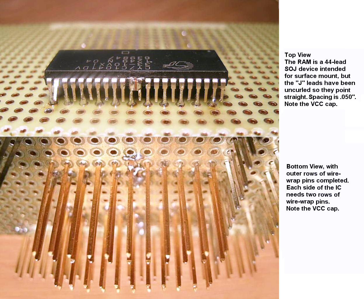

I'm the one. It took me a while to find where I'd posted this! But it's on page four of Techniques for reliable high-speed digital circuits.
There's lots you can do with J-leads -- I'm quite comfortable with them (and the .05" spacing). But be sure your soldering iron is one with a fairly fine, conical tip. Chisel-shaped tips are not what you want.
I've also worked with the packages with finer pitches (below .05") but the soldering technique is different. Rather than soldering individual pins, you flood ALL the pins with solder then remove the excess. It's not terribly difficult, except that stuff that small is so darn hard to see !
