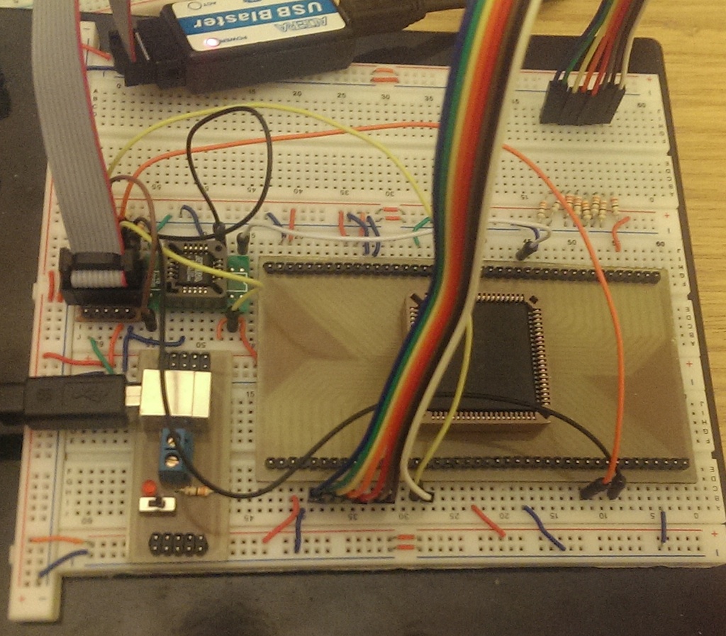

I have used a few adapters bought from eBay. I've also made up a few of my own since they are fun and easy to make. Here's a picture showing some of them in use:
This shows:
:arrow: PLCC84 adapter: The biggest one I've made up. You can buy these from specialist suppliers, but they are big money, so I made one with my toner transfer + FC + Dremel drill press home PCB method. I was quite pleased with this!
:arrow: PLCC22 adapter: nothing to say about this really, bought from ebay. I have some '44s as well.
:arrow: Power adapter board: I made this up for fun and because I got fed up with dodgy USB hacks. At some point I will buy a bench power supply...
:arrow: IDC10 adapter: Useful for AVR projects. I also made a IDC40 adapter which was used for my IDE interface prototype, and other things. Those were made with stripboard and a very fine knife cut down between the two rows of pins.
Other bodges/hacks:
:arrow: A Shrink DIP64 to 0.1" pin adapter (PCB) for playing with a Yamaha V9958
:arrow: Flex connector (irritating staggered 2.5mm pin spacing) to DIP adapter (PCB)
:arrow: Attaching a bit of strip board to one end of a SCART cable
:arrow: 3.5mm sockets...
All kinds of things are possible. I love my breadboards. :)
