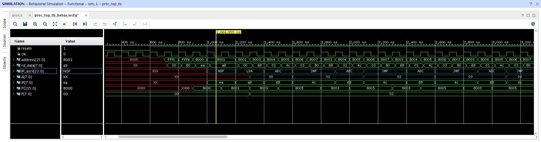

I've incorporated the ALU into my design and wrote a simple ROM to reset, do NOP, clear out the accumulator and start counting by 1. Now that I look at it, I think there is a bug in the ALU not clearing the zero bit in the status register. It took me a bit to figure out how to pipeline data through the ALU, but looks like it's working. I don't think that implementing the rest shouldn't take too long now.
