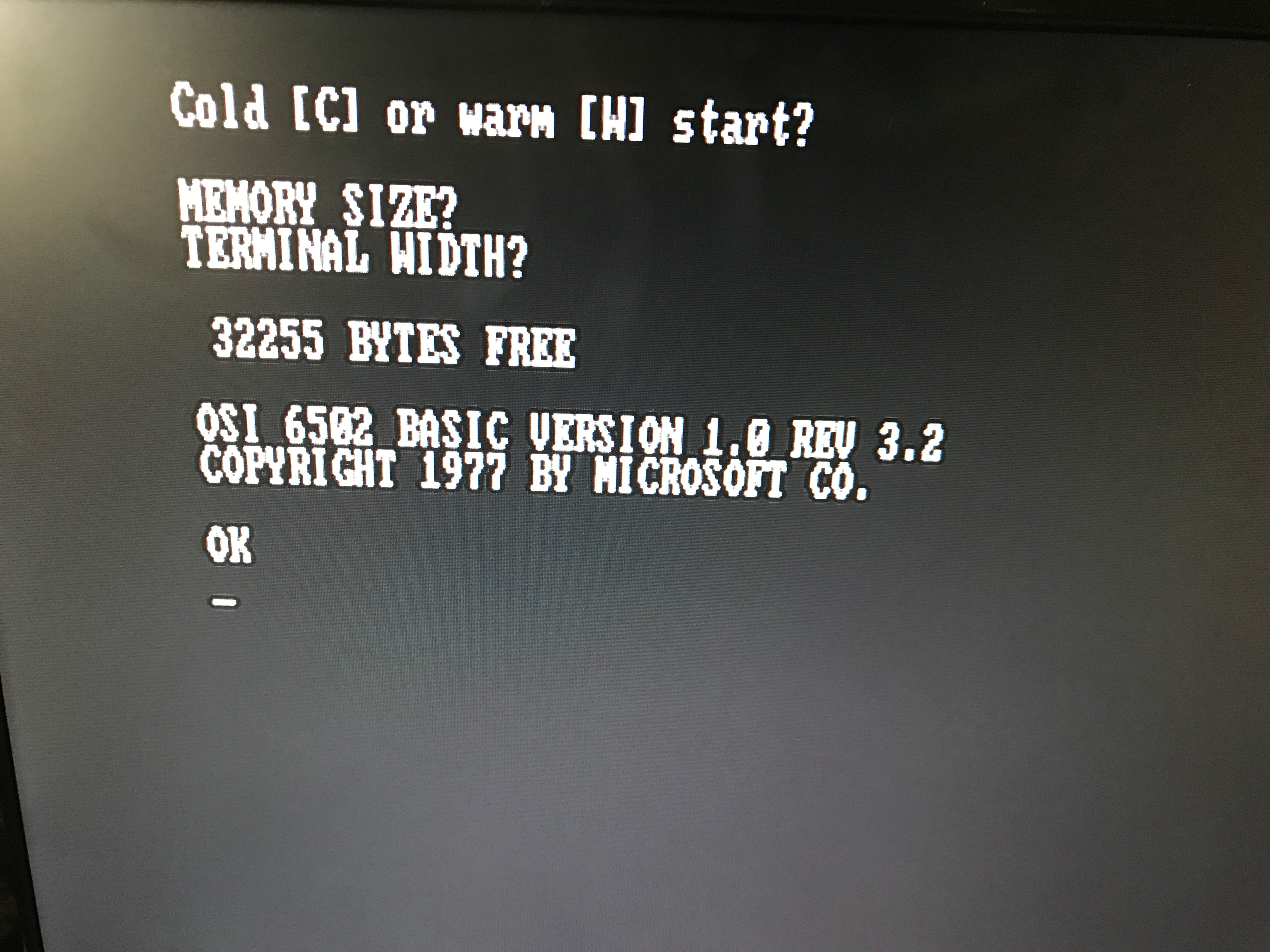

Hi,
I have built one of Grant Searle's 7-chip 6502 computer based on his modified OSI Rom with Load and Save "nulled"
Is there an easy way to implement Load and Save and add the required circuitry to use a tape recorder to save and load code.
If so can anyone help me with the schematic and code.
Thank you.

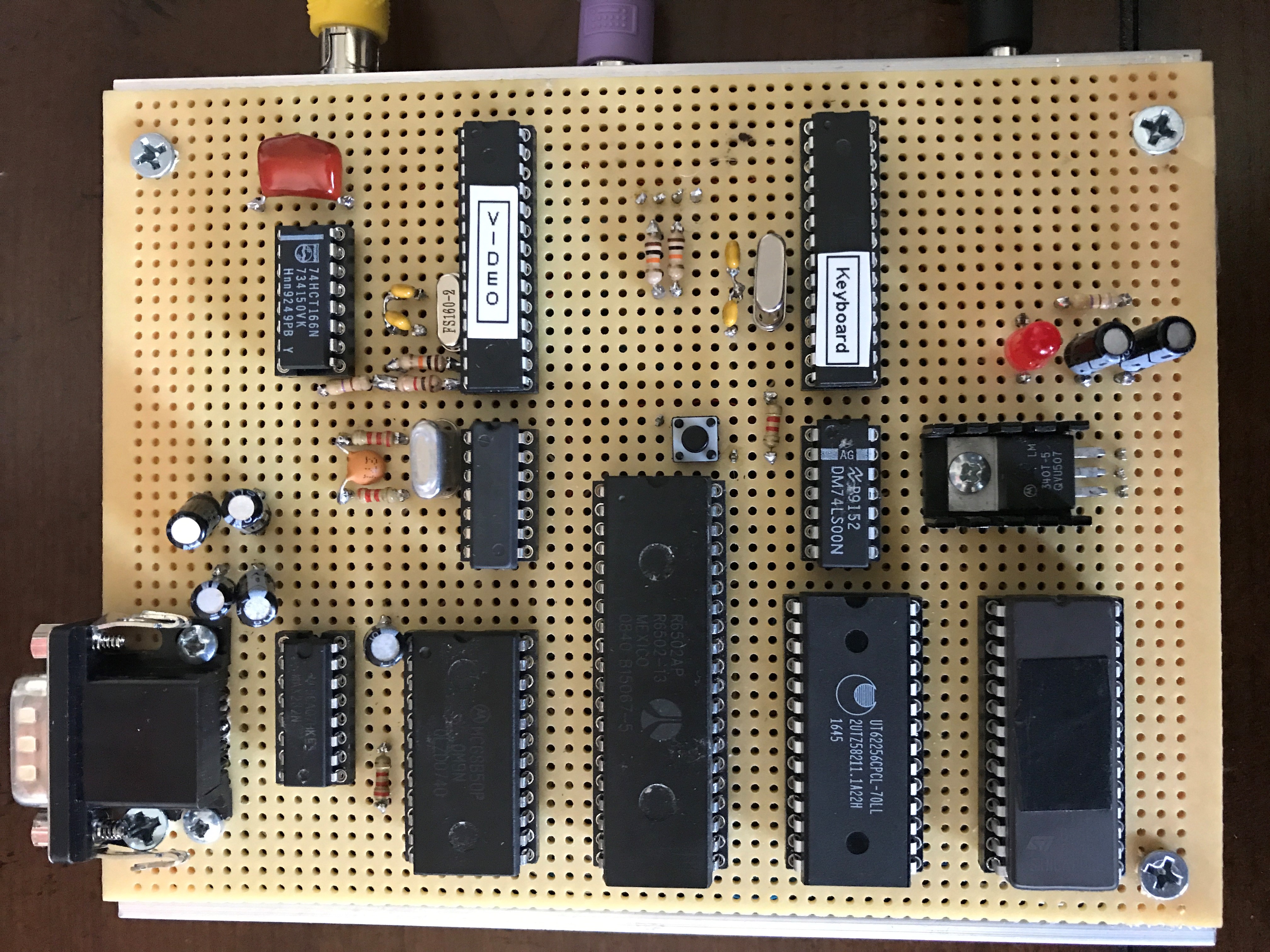

6505 screen
6505 screen
Top side of the 6502

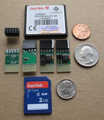

I and Daryl (8BIT) have used I²C EEPROM modules made to the I2C-6 connector standard.  Mine look like this:
You can see the 8-pin DIP under the translucent heat-shrink.  These top out at 32KB for simple addressing, and, I believe, 128KB for addressing them as four 32K's in one IC.
More recently, I've used our SPI-10 hobbyist-friendly connector standard and I have the tiny PCBs for these flash modules shown on the front page of my site available to supply to others.  If you just want a few, the cost is hardly more than just the postage.  They're about half the area of an SD card, but the flash memory that goes on them (I'm using 4MB ones in SO-8) is much simpler to interface to in terms of your software.  Here's a picture, comparing them to the size of SD card and Compact Flash:
The one slight drawback about the flash modules though, unlike the I²C ones, is that they require 3.3V, so you'll probably have to do voltage translation, which is easy to do since there are only four signal lines and none of them are bi-directional.  (You'll need a fleapower 3.3 power supply of some sort too.  I've use an LM317LZ in a TO-92 case.)

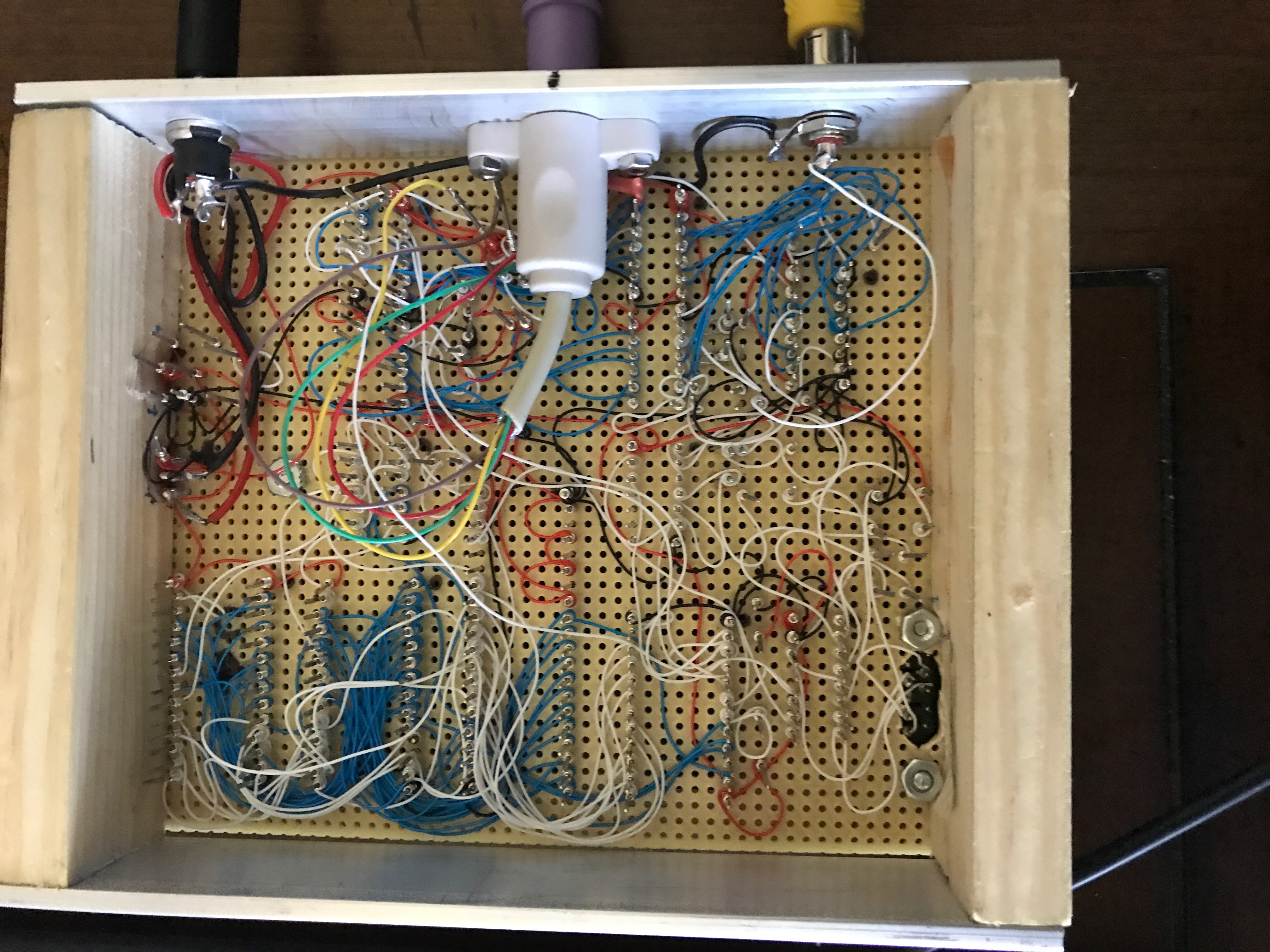

Neat looking perf board SBC. You should include a picture of the underside so we can marvel at the wires going every which way!
cskordis
Posts: 3
Joined: 10 Jul 2017
Re: Adding tape storage
Post by cskordis »
And the underside of wire wrapping nest!
