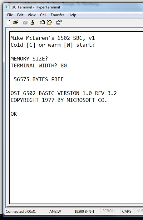

bluesky6 wrote:
If you are just running a basic program loader or a Monitor, you can go as high as 62KB of RAM minus the i/o space.
If you want to include a variant of BASIC plus the Monitor or just BIOS, you might be able to get 56KB of RAM. Some variants of MS BASIC build to 8KB. I found that with EhBASIC, you'll need more ROM space e.g. 12KB if you include a monitor.
I've used a build of Grant Searle's modified OSI BASIC that runs in $E000..$FEFF with a monitor in page $FF and I/O mapped into page $DF which does indeed provide almost 56K of RAM.
