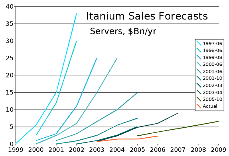

Re: MOS6502 Release Schedule
Ah Itanium, that was supposed to take off:
I haven't checked the benchmark scores, but when we were building out the compute farm in our chip team, we went from 450MHz SPARC in Sun Ultra boxes, to 933MHz Pentium III in IBM boxes, to Athlon something or other (1200MHz??) in Supermicro rackmount units. Up to that point we'd run headless desktop style units. At some point we also got an H-P PA-RISC system, but mainly because it could be fitted with a huge amount of RAM. I'm not sure what huge was at that time, maybe 16G, maybe a bit more. So, it feels like there was a window when Pentium seemed like a better choice than SPARC, and AMD weren't in the running.
