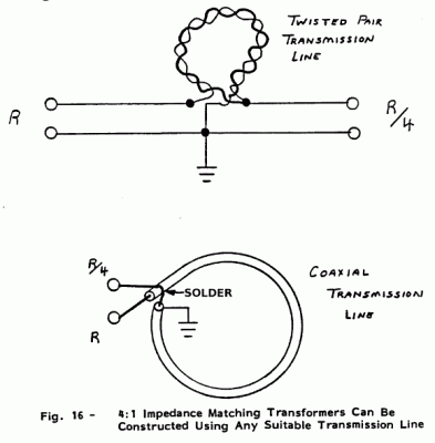

That's what he transmission line turns it into, two equal-amplitude signals, 180° out of phase, assuming it's long enough.  (If it's very short, like an eighth of a wavelength, you would need to put a ferrite core over the pair.)  One conductor may be grounded at one end, but at the other end it has just as much signal as the other conductor.
You can do some really cool stuff, like this:
(This is from a seminar from when I was working in RF, as is the next diagram.)
Any conductor has inductance.  In the transmission line, current going through one conductor faces an inductive impedance from having to build up a magnetic field around it.  The impedance, by definition, pushes back; but if the other conductor is right there, it pushes back in that one just as hard, because of mutual inductance.  If it can make the make the same current flow in the second conductor but in opposite direction, the net current at that point is zero, so there's no "pushback" fighting the signal.  For really short transmission lines, putting a ferrite bead over the pair of conductors, or putting the pair through a toroid, improves this effect.
When I worked in applications engineering at the VHF/UHF power transistor manufacturer, we sometimes made 4:1 or 9:1 transformers with coax.  Here's how a 4:1 is connected:
Again note that although one conductor is grounded at one end, it's the signal at the other end.
