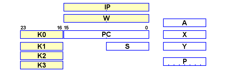

Posts: 3526
Re: What if independent MOS Technology had survived?
Thanks for the mention, Garth.
Prefix bytes are a potent solution because each consumes just a single place in the opcode table but it makes possible 256 new encodings. Unfortunately, the prefix occupies an extra byte of memory. Also, fetching that byte entails a certain delay.
So, there's a tradeoff. A single-byte opcode is fastest, but a prefix-plus-opcode combination is more versatile because more encodings are possible.
KK implements both. The prefix method is the most flexible way to specify a "Far" data access — that is, one whose data has a bank address that's independent of the bank where the currently-executing code resides (per K0). The desired prefix (either K1 prefix, K2 prefix or K3 prefix) is followed by and acts upon any typical 65C02 data-access instruction such as BIT Abs, INC Abs, CMP (Ind) and so on. During that following instruction the 'C02 creates a 16-bit address in more or less the usual fashion, and KK makes the alternative bank active only during the instruction's data access — ie, typically for one cycle only :!: (three cycles for Read-Modify-Write).
The other method involves only LDA and STA. These are used more frequently than other data-access instructions, and to improve performance KK sometimes allows them to omit the prefix. In order to conserve encodings this capability is limited to a few carefully selected cases.
  • opcodes $D3, $F3 and $E3 apply K2 to LDA Abs, LDA (Ind,X) and LDA (Ind),Y respectively
  • opcodes $93, $B3 and $A3 apply K1 to STA Abs, STA (Ind,X) and STA (Ind),Y respectively
In other words $D3 (for example) acts as "2 in1"— ie, both the prefix and the opcode itself. The mnemonic is LDA_K2. Altogether (including the two operand bytes for Abs mode) the instruction occupies 3 bytes, and it executes in four cycles, with register K2 supplying the bank address only for the last cycle.
KK Register Diagram.png (8.39 KiB) Viewed 977 times
