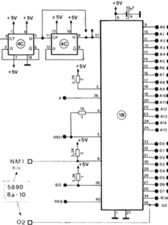

I'm completely blown away that the mighty ELKA Synthex synthesizer (Jean Michel Jarre's laser harp, anyone?) from 1981 used a 6502 as it's main processor. I did not know until I browsed through the schematics yesterday and had to look twice at the processors pinout. See attachment.
Cool, that makes Jean Michel Jarre and Stevie Wonder two rather prominent 6502-Users.
Still, I think the circuit is rather weird. Why did they hook up the IRQ line to Pin 5, which is N.C. according to the datasheet?

Well, it does connect to /IRQ (pin 4), but the signal passes through that 1K series resistor.
We can only guess what the intention was. And my guess
is that it was a troubleshooting aid. One could tie pin 4 high to inhibit interrupts -- and, at the same time, observe pin 5 to see whether an interrupt was being requested. Certainly there could be other explanations, though.
