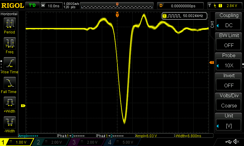

I have gotten to the point where I'm trying to output a pattern on the VIA ports that I can probe. Nothing comes out, but I did find what I think is a problem.
The following scope shot is the CS2 pin on the VIA. I'm at 1V/10ns per division. Its just a quick blip! By comparison, the CS1 pin goes HIGH for 3us, which sounds about right.
I have activity on all the pins I'd expect, and so far this is the only signal that looks suspicious.
I'm using the first decode circuit on Garth's primer. all connections seem good, and the meter says I have continuity. On the scope, the CS2 goes LOW at the same time the CS1 goes HIGH. This tells me at least that portion of the decoding is good. Also, since the VIA is being selected at regular intervals, along with all the other activity, I feel that my program is running (it is an endless loop of setting the VIA ports, and yes, I set the DDRs to all ones). If my program is running, then that means ROM addresses are being decoded too.
So I'm pretty shir that skinny pulse is my problem.
Ideas?
Have you posted a complete schematic of your machine somewhere? I don't recall seeing one. It's going to be kind of difficult to help you troubleshoot this problem without a schematic.

PostPosted: Thu Mar 23, 2017 5:18 am
Posts: 276
Location: Lynden, WA
Also, it is some sort of decoding error I think. A14 should go HIGH and A15 should go LOW every VIA access. I only have A14 going HIGH when A15 is HIGH. What I think is causing the short pulse is that the NAND gate that selects the VIA is getting a nearly, but not perfectly simultaneous LOW and HIGH at the same time, and that the sight delay briefly allows a short output.
That would just be a symptom though. Those signals shouldn't be doing that.

PostPosted: Thu Mar 23, 2017 6:00 am
Posts: 276
OK, semi success!
The original problem was that in the melee, I'd over written the crucial part of the ROM that tells the thing what to go do with itself when it turns on. Fixed that, and BAM, output on the VIA!
It's strange though. I put $AA on both ports, which to me should be 10101010. I get 01010101. Both ports have this. I'm gonna Change the desired output and see what's up. Maybe all ones to one port, all 0s to the other.
