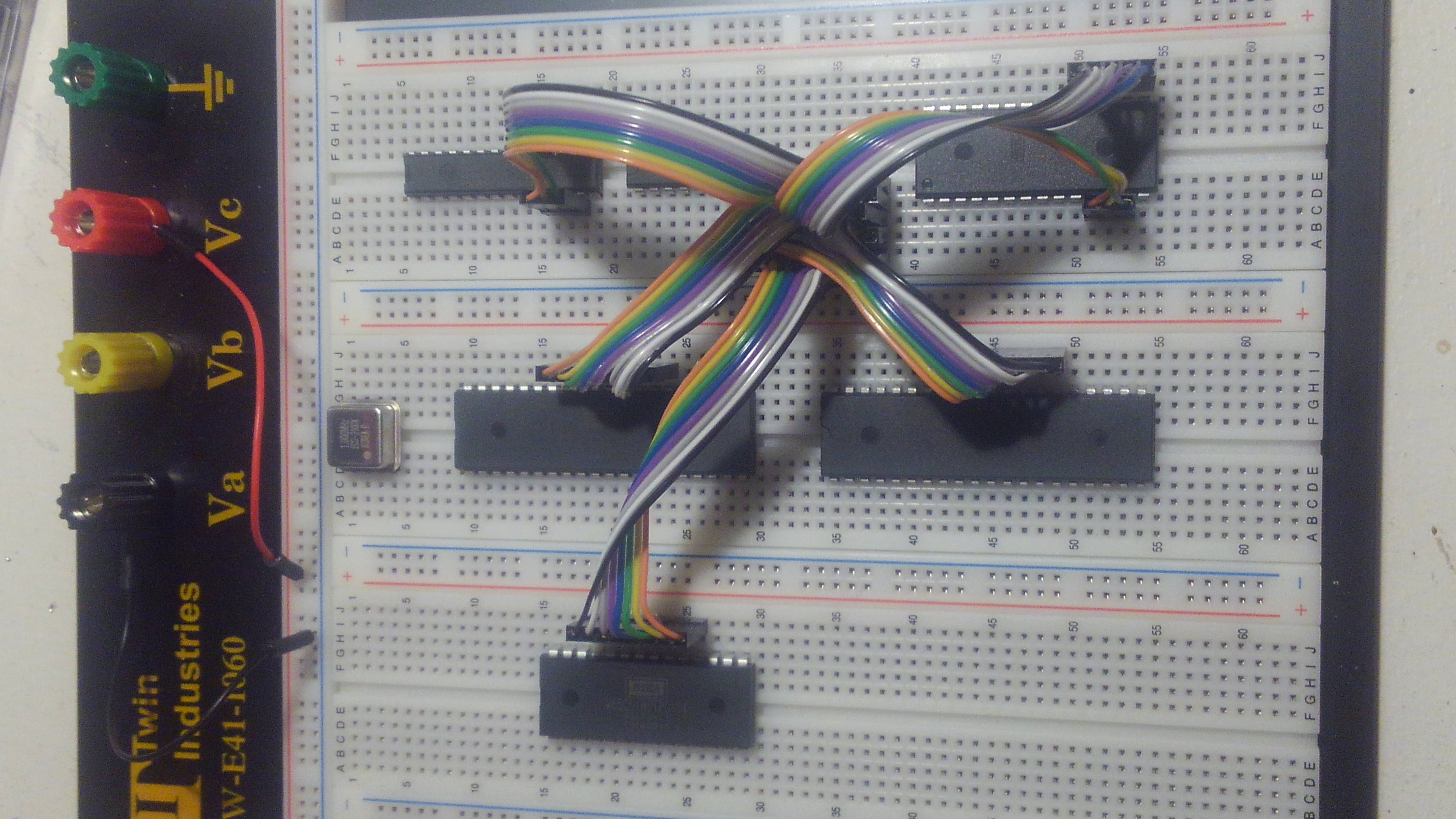

On the good advice of others here, I will now be posting my progress on one thread. I also decided to name the thing, and I suspect anyone around here will get the reference. (Heck, it's probably been used already!)
OK, in the spirit of one stop shopping to find info on what I'm up to, here's the current plan:
Simple 65c02 build, initially on a breadboard. 1 MHz.
6522 VIA
6551 ACIA. I currently have the buggy WDC part, but the improved Rockwell part is in the mail.
32k SRAM
32k ROM
Garth's simple single 7400 based address logic. (I prefer the simplicity over the slightly wasted memory for now)
FTDI chip to get the UART talking to my PC.
My future "stuff I wanna do when I am smart enough"
On board video processing with composite out
On board keyboard processing, hopefully period accurate, but that's not a necessity.
Here's the buggy that will really stretch me. I want to write some sort of compiler/assembler/interpreter (one of the three) for the thing. I love the idea of using an assembler I wrote on hardware I built. I think it would require a pretty well rounded knowledge, and thus would direct my learning in all the right places.
Here's what I have so far. Just the data bus is hooked up. The ribbon cables are all custom made by me so I can have the lengths I want.

Someone mentioned that my star scheme with the data bus could cause problems. Care to elaborate?
I'm interested to hear the theory behind this as well. I'm mostly a software guy, so I have nothing much to contribute, just curiosity.
