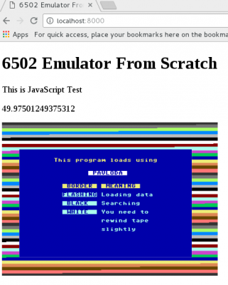

Probably one of the most sensitive tape fastloaders used for C64 games on tape was the Pavloda fastloader.
In fact some of the games that used this loader even suggested keeping the C64 away from the TV.
Even when emulating the loading of a game using Pavloda is a tricky task. It envolves getting CIA timing right exactly together with Vic II raster/bad line timing. I think to the list one probably also need to add accurate emulation of tape pulse timing.
In my emulator I think I have waxed the CIA timing with the help of Matt's video on emulating the Beep in JavaScript.
I also more or less waxed the Vic II timing, but I am still missing something.
Does anyone perhaps know of any articles explaining the technicalities of the Pavloda fast loader system?

Here is my findings so far.
First, a snippet of the key assembly code:
;start tape motor
.02AF 202 034   64523752  A9 1F       LDA #$1F   fe0108ee
.02B1 202 036   64523754  85 01       STA $01    1f0108ee

I got this source code via a raw trace from Vice, so don't worry about the extra numbers.
We start at address 2AF where we switch on the tape motor. At this point in time the tape head is positioned at the beginning of a 3 second pulse.
Eventually the subroutine at 128 will get called, which will spend most of its time waiting till we are passed the 3 second pulse.
It might not be obvious from the code, but the tape loader makes use of timer A and B from CIA 2.
Timer A is set to always count 90 o2 pulses before underflow.
Timer B is set to count Timer A underflows. How much Timer B counts before underflow is always set at the end of a tape pulse via a lookup table. The value of timer B at the end of the pulse is used as index into the lookup table.
It should be noted that the first time we get a value from timer B, we are dependant on initial startup conditions of the C64. Therefore the first value we will get from timer B will always be $ff. In the lookup table this will translate to a new timer value for timer B of $20.
If you go through the code, you will see the use of two lookup tables. I am listing them here:

Another interesting happening is the modification of the opcode at 3EA.

I have kind of made some progress to account for missing cycles in my emulation.
Most of the missing cycles was small bugs in my VIC-II cycle emulation.
Still at the VIC-II cycle emulation, however, I am battling to get the emulation of bad-lines perfect.
I am working through a VICE trace log as reference and I am not sure how VICE get to bad line figure.
From quite a number of sources on the net I found that badlines is 40 cycles plus 1 to 3 cycles to accommodate possible writes of a CPU instructions. So, in effect a bad line can be between 40-43 cycles. In the majority of cases a bad line will have the length of 43 cycles.
I am adding a couple of VICE trace log extracts for badlines. It would be great if someone can perhaps explain cycle by cycle how you would derive the bad line cycle length for each scenario. (PS. For those not familiar with the VICE trace log syntax, the second column is the current raster line at the beginning of instruction and third column is current cycle within that line, also for the coming instruction).

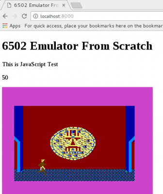

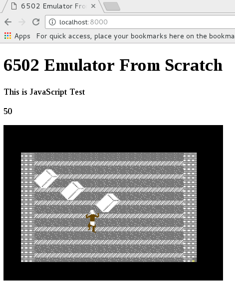

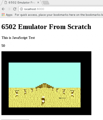

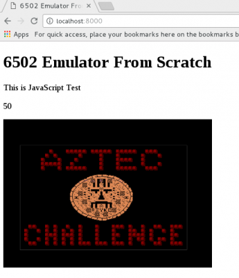

Just to let you all know that I manage to load game that uses the pavloda loader within my emulator.
What an exercise!
Apart from the badline emulation, I was also missing things when emulating the cascaded configuration of the 6526 timers.
Cascaded configuration is where timer B counts timer A underflows. Here I was missing two things.
Firstly, I was only supposed to decrement timer B about three clock cycles after timer A underflowed.
Lastly, I also missed the fact that with cascaded configuration, timer B counts to zero and then do a reload of the timer. This is a bit different than in 02 where we only count down to one and then doing the reload.
For nostalgic value, here is some screenshots:
