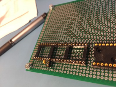

Anyway, I'm wire-wrapping a 65C02 computer and I'm trying NOT to solder anything. Mainly because I'm using the larger, more expensive breadboards and I make a lot of mistakes. :-D
So, I was thinking...how can I put passives on without soldering? Also, my wire-wrapping skills aren't good enough to wrap two poles 0.1" apart. So I had a brainstorm.
Why not put a 1x2 cutoff strip next to the power (for my bypass caps) and use a jumper on the bottom side! I have a crap ton of those jumpers and I think they may work pretty well for the few one-offs that I need right up next to the components.
Well, this was one of those moments where I thought to myself..."why didn't I do this before?" :-D
Oh, I'm sure I'm breaking every rule in the book but oh well. It's fun.
:-D

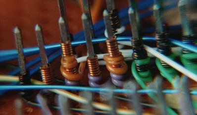

Answering Wire-Wrap (WW) Questions and Doubts: http://wilsonminesco.com/6502primer/WireWrap.html
The pin's clean, sharp corners should bit into the wire four times in every turn, not having the bare wire go outside of previous turns. If you keep to this, you won't have any trouble wrapping wires .1" apart and running more wires in between on their way by, and you'll have a 100.00% reliable connection, for as many decades as you want to use it, without soldering.
The black ones here are silver-plated wire that's tarnished unevenly, but the wraps are even. The smoothness is more visible in the copper wires. The neatness is for reliability, not looks.

I started a wire-wrapped computer a while back and I did that. I soldered a pin on each wire-wrap socket. I *really* wished I hadn't done that. I've started another wire-wrapped computer and so far I haven't soldered any sockets at all. I find the wire-wrapping is so strong, that the socket actually feels soldered on. Think about it, you typically have 16, 24, 28, 40, etc. pins each with a solid connection. The first wire I put on the pin, I try to make sure it's flush with the board. That keeps it from flopping around.
Now, going back to my first wire-wrapped computer...the one with the soldered pins. I've been trying to take it apart for hours. I've cut wires, "un-wrapped" them with my wire-wrapping tool, etc. It's incredible how secure those wires are.
When trying to de-solder the pins, I've managed to break a couple of them. Which REALLY sucks since some of these sockets are $5 each.
Fortunately, you can buy a row of pins from Jameco for a few dollars. I can then pull the pin out of those and repair the more expensive sockets.
So, in my new wire-wrapped computer, I haven't soldered anything *except* for a few sockets. But NONE OF THE SOCKETS are soldered to the board.
What I did was take some 8 pin wire-wrap sockets and soldered 3.3k resistors on the pins. I then wire-wrap this socket and use it for pull-up lines. I've done the same thing with capacitors.
I find that works pretty well. And, the great thing is that I can reclaim the sockets even easier the next time because none of them are soldered to the board.

If my computer were going to be moved around a lot, in an environment with lots of vibration, then I might do something different. But like I said, once the sockets are wire-wrapped, they're not going anywhere.
