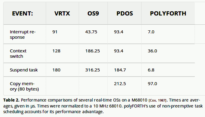

  • task-switching times of different OSs on the 68010, with PolyForth's being many times as fast as the others (under the "2.4.3.6 Multiprogramming" heading)
    The text says, "In theory this non-preemptive algorithm is vulnerable to a task monopolizing the CPU with logically or computationally intensive activity, but in practice real-time systems are so dominated by I/O that this is rarely a problem.  Where CPU-intensive operations do occur, PAUSE is used to 'tune' performance."
