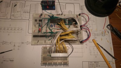

 Post subject: Re: Help using cc65
PostPosted: Sun Mar 05, 2017 5:47 pm
Joined: Sun Mar 05, 2017 4:31 pm
Posts: 36
Hey jeff, good call!
First off, i included a picture of my system:
(bottom left is where the eeprom sits, the board on top is just an arduino acting as a variable clock, and the board on the bottom is just a bunch of led's connected to the data and adress lines.)
I am using a
R6502P cpu
R6551AP acia
at28c64b eeprom
tc551001cp-70l ram
I used the same memory mapping as described on this website: http://www.loomcom.com/projects/6502/

How far have you got with software? Can you run something which toggles the LEDs, say?

The furthest i have gotten in terms of software, is filling the eeprom wit EA, wich is hex for the NOP opcode.
This way the led's ont the data lines display the value of EA in binary, and the adress lines start counting up.
As far as Jeff Tranter's port goes, I have no idea how to implement this.
