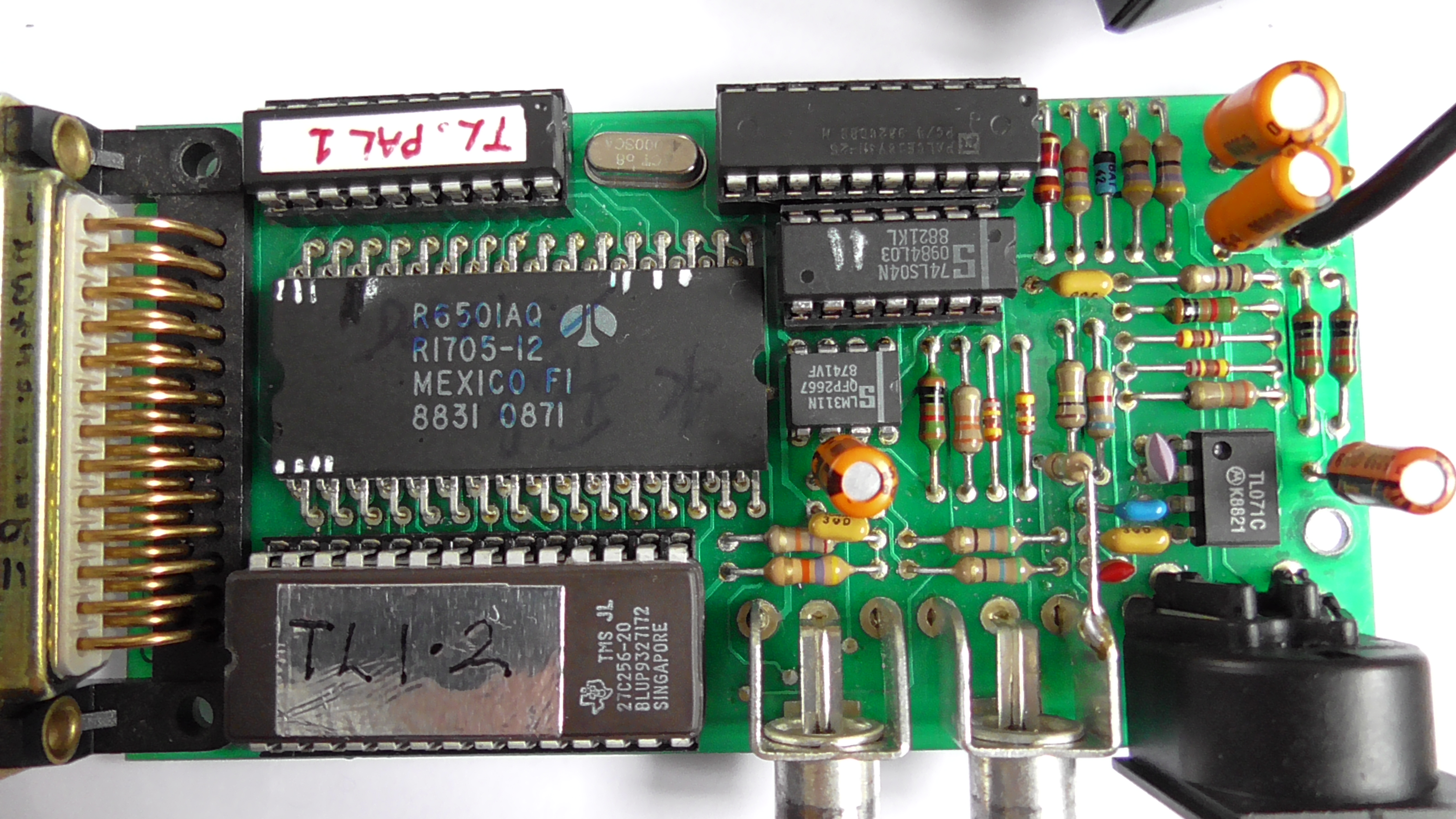

The project is called a Steinberg Timelock. It synchronises a Midi sequencer on the Atari ST with SMPTE time code ( a bi-phase synchronising signal, says the interwebz )
Inside there are 2 x protected PAL16R8 devices doing some counting etc to decode the bi-phase signal into clock and data 1's and 0's. It's taken me about 3 months to reverse engineer those 2 PAL chips with my HP 1661 and ABI Boardmaster 4000 so I might as well go the whole hog and see what the rest of it is doing :-). I'm feeling confident for a change.
Thanks
Martin
If the photo works it will show my replacement PAL16V8 devices.
