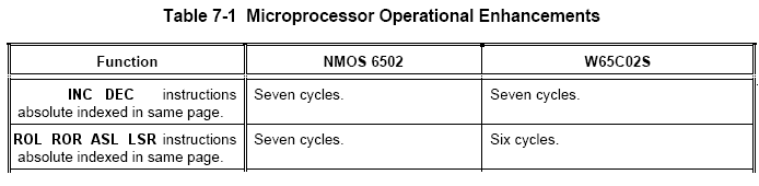

Yes. And the 'C02 fixed the problem... but, curiously, for some but not all of the RMW instructions. :!: Moreover, the documentation fails to accurately describe this! See dclxvi's thread, A 65C02 bug?
Table 7-1 excerpt (original).gif (6.04 KiB) Viewed 8526 times
I wrote:

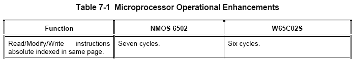

indexed addressing raises the possibility of a page crossing, which means an extra cycle may be required prior to the memory access. But for some indexed Read-Modify-Write instructions an NMOS chip will always include an extra cycle, even when no page crossing occurs. [...]
Table 7-1 of the WDC datasheet claims this issue has been corrected for the CMOS version, but in fact that's only true regarding ROL ROR ASL and LSR. INC and DEC are also Read-Modify-Write instructions, but the fix does not apply. Table 7-1 should read as shown below.
Table 7-1 excerpt (corrected).gif (8.17 KiB) Viewed 8526 times

Aha - I just had a lightbulb moment of my own. I noticed Jens' "true cycle" core is intended for use in an Apple II disk application - where cycle-accurate timing is everything. I wonder if the unimproved instructions, the ones which apparently have some unoptimised logic and take one more cycle than they need to, were used by Apple's 8 bit code, and for compatibility purposes had to be left as-is?
Posts: 3526
Re: Question About Absolute, X Timing
I wonder if the unimproved instructions [...] for compatibility purposes had to be left as-is?
Interesting idea, Ed! :shock: The context is 65C02, but I'm reminded of another thread which mentions the 65816 getting its evolution reversed because that's what Apple wanted. :|
