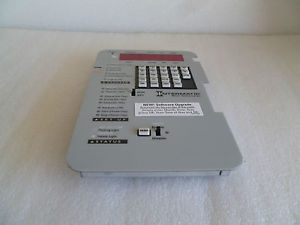

I thought about these: http://www.ebay.com/itm/231598548744
In the distant past, I've thrown quite a number of them in the trash due to physical damage, or just the owner wanting to do something different. I never tried to keep one, as I always assumed other people would be throwing them out too, and if on the odd chance I'd ever need one they should be easy to get second hand. But apparently they are selling for more than I expected. That one is $50 but I see some selling for $300 and up.
These things have a Rockwell 6502, a fair amount of RAM, and a good amount of I/O. I wish I had tried to keep some.

(Just in case of link rot, here's an archived version:
"INTERMATIC NEXT GENERATION PROGRAMMABLE TIMER ET142402D"
Looks like it has 23-key keypad, 6 digits of seven segment display and 14 indicator LEDs

They have a number of high current relays inside. Depending on the model, they have one, two, or four.
In my experience, if it looks like that one in the picture, metal box, 6 digit LED plus the row of LEDs and the big keypad, then it has a 6502 inside. It seems like they used that design for decades before going the China route. I don't know what's in the Chinese ones, but they look very different.
These things are typically used for large arrays of luminaires inside large industrial, retail, or warehouse buildings, as well as outdoor lighting on such buildings. The ones with multiple circuits can handle both chores simultaneously quite well. I've also used them for break buzzers in manufacturing settings. The programming is tedious but very powerful.
