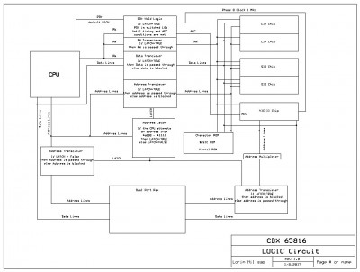

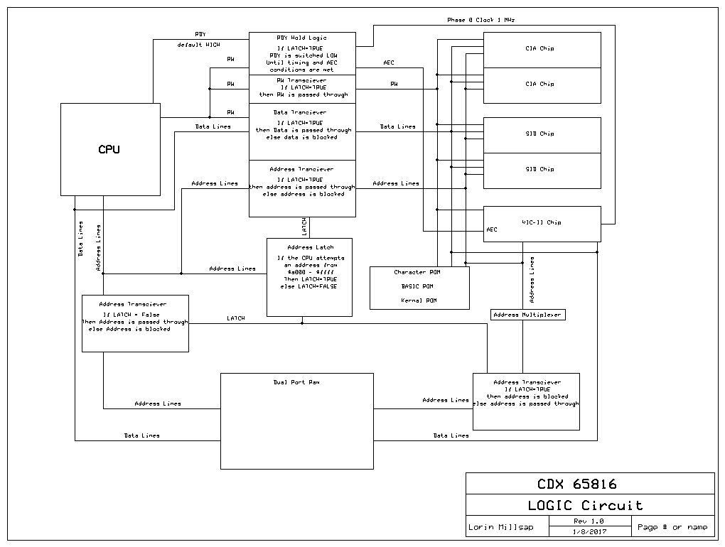

Ok, here is a rough diagram of the logic I am considering (this will slow the CPU down to access the 1MHz bus. Obviously a lot of details need to be considered. But as a rough idea this is what I am thinking.
