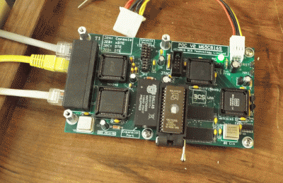

I think I've licked the problems with getting the QUART to do what it's told. Here are some pictures taken during testing to determine if I was on the right track.
File comment: POC V2 Undergoing Test
Above is POC V2 with power applied and connections to three of the four serial ports. Two of the connections go to two different terminals and the third one is a data link to my Linux software development box.

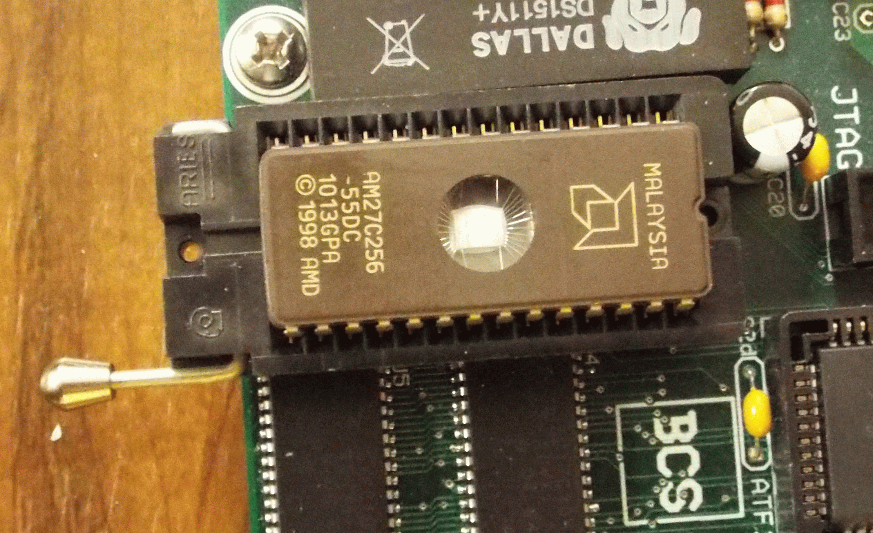

File comment: EPROM in ZIF Socket
Above is the test EPROM mounted in a ZIF socket. I should have done this on POC V1 but oh well! :D

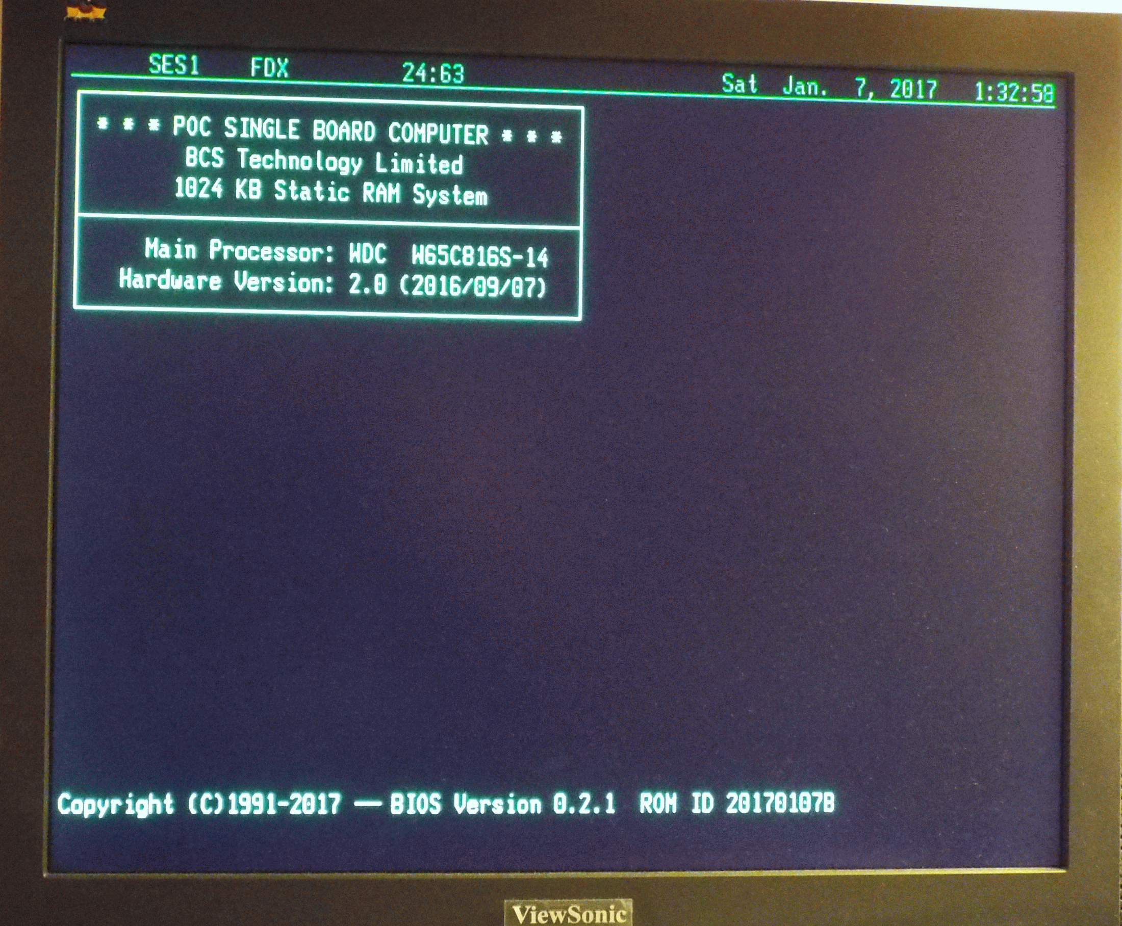

File comment: POST Test Banner
Above is a test banner printed to one of the terminals. Obviously most, if not all, of POC V2's hardware must be working in order for this to have happened. One of these days I'll figure out how to get sharp photos of the display. Shame I don't have any hardware that can capture the image right off the VGA port and dump it into a file somewhere.
The great thing about the QUART is it has four high speed TIA-232 channels, two precision timers and an assortment of I/O pins to use for various purposes. The not-so-great thing about the QUART is that a whole bunch of configuration has to be done to get all those channels and gadgets working. The method I developed for setting up the DUART in POC V1, which was a single data table with configuration for everything, turned out to be too cumbersome—the size of the table got ridiculous and I could foresee that it would be hard to maintain. It was certainly hard enough each time I had to change something to correct a problem. So I concocted a new method.
NXP UARTs are organized into functional blocks, each of which contains one or two UARTs, depending on the particular device. Quadruple UARTs are actually two DUARTs in one package, and the elephantine 28L198 octal UART is four DUARTs in one package. Visually, the device architecture looks like this:

Early in the development of POC V1, I was going to use an EEPROM. However, I have an erasing rig that can do 20 EPROMs at a time. Also, I have a bunch of 256Kb × 8 EPROMs with a 55ns rating. So it's just a matter of waiting until I have about 15 used EPROMs and then putting them in the eraser and clearing them en masse. I always have at least 5-or-so blank EPROMs handy at all times, so I'm not losing much time going this route.
The 55ns EPROMs were necessary in POC V1 in order to run it faster than 8 MHz, as that design had no provisions for wait-stating.

Aslak3 wrote:
I've only seen ZIFs with rectangular pins; I assume your one has round pins?
It does, 18 mil pins, to be exact. It took some searching to find this socket but has worked out well.
