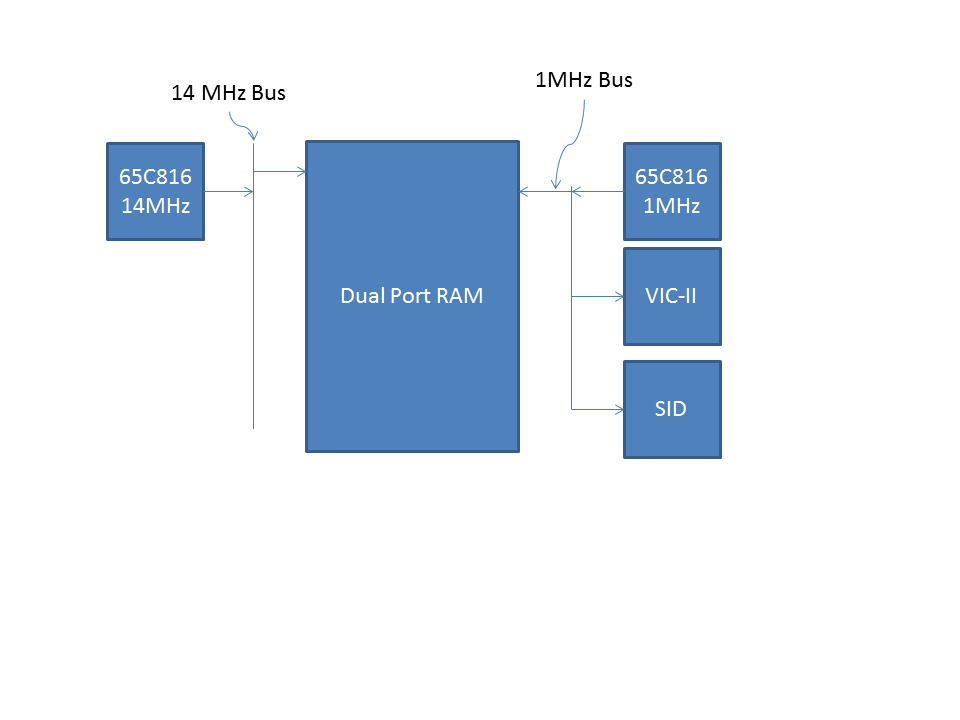

With a number of chips required to build a bus-bridge to run the VIC-II and SID, it might be simpler to use two 65c816's. Run one at 1MHz rate on one side of the dual port ram with the SID and VIC-II. On the other side of the dual port ram run a high-speed 65c816. The slow side could be held in a reset state until the system is ready to allow it to run. Have the slow 65c816 check for requests from the fast side and perform the requests. Some dual port rams have interrupt outputs that could be connected.

So in other words it's realistically not doable to have a buffer. It just doesn't solve anything. Having dual CPUs is a possible option, except that it is not software transparent and as a minimum would add several CPU cycles of delay while it handled the request.
This puts me back to one of my other two options, slowing the CPU down to the 1MHz speed when it accesses one of those memory regions. This is way slower than the CPUs potential, but never slower than a real C64.
The other option is replacing the VIC-II with a FPGA equivalent. Something that mimics the VIC-II in function without its handicaps. While this option can't give full compatibility, it would be close enough most of the time. Some extra pros to that method would include: VGA output, ability to add extra graphics modes, and the ability to synthesize other functions. This is both a simple and complex option.
Using a buffer that is constantly updated might solve a bit. You still have to look carefully where there the buffer possibly could be not up to date and then either kick in RDY or work around in software.
But on the other hand: your machine will not fully behave like a real C=64 anyway. Programms requiring NMOS undocumented opcodes or NMOS timing might not work. So question is: what exactly is your goal?
Then you can compare possible solutions:
- buffer: CPU running as fast as possible, but quite an amount of work to get it working.
- RDY or clock stretching: CPU being slowed on accessing SID/VIC, but much simpler to implement
- Robs way of a dual CPU system. To me sounds most complicated. On the other hand: hooking 65816 on C64 expansion bus with its own memory, keeping internal 6510 working as kind of I/O slave, freezing the internal CPU to pass data to internal slave when needed...
- replacing VIC: as compatibility as limited anyway, this could be a "cheap" solution allowing for features that are important to you.
- hooking VIC to a 65C22 with some data bus buffers to avoid contention when VIC plays bus master. You would have to make sure by software that reads/writes are synced with VIC-timing, but CPU could keep running and do something instead of RDY-sleep. Concerning compatability this is far off, but alas...

Another wrinkle in trying to externally mirror the registers is that the CIAs and VIC-II have registers which perform an action on read, like clearing latches. These chips are made to have reads & writes occur at the time the programmer specifically intends them, because of side effects like this as well as timing constraints. It would also be too much of a hassle to separate individual magic addresses which are "safe" to mirror and others which have side effects, so I'd say get rid of the mirror.
The SuperCPU model, which buffers writes to any 1MHz address without slowing down (unless the buffer is full), and synchronously waits for a 1MHz read for those addresses on the 1MHz bus, really does seem to be the most usable solution, IMO. CMD had some decent thinking behind many of their designs, for compatibility and usability. Any time you simplify the implementation, you're generally going to be putting more burden on the programmer. It'd be great to find something that simplifies both, but it's hard to see one, especially if you want chip access to work like a C64.
If you want to break a bit from the C64 model, other systems deal with crossing buses by having a memory mapped address + data register which reads/writes to the foreign bus instead of directly interfacing the CPU bus, like the C128's VDC and many game console chips.
