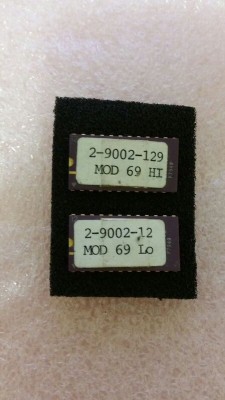

EPROMS 2516

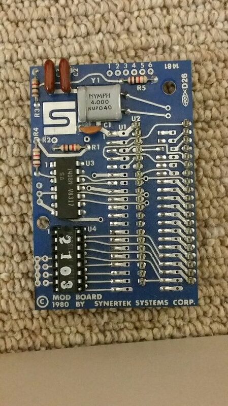

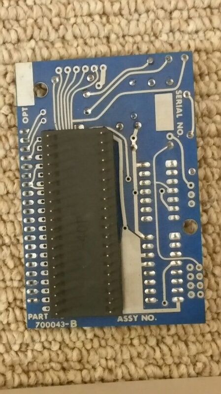

Upper Layer PCB traces with CPU removed
Lower Layer

Attached are the binary images for the two 2516 Eproms that shipped with the Sym-1/69 Mod Board.
Reading the 82S123 Prom is going to be somewhat trickier, as my Eprom programmer doesnt support it.
However, this PROM is simply generating an NMI for certain address pages, in order to support the SYM's debug function.
With the 6502 based SYM, this was done using the SYNC pin, however as already mentioned by others, the 6809 does not have such a pin.

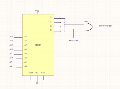

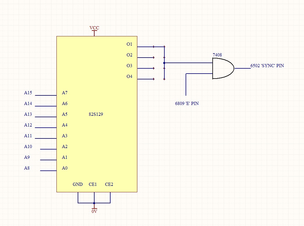

Above is my crude reverse engineering attempt at the mod boards glue logic.
Quoting from the manual..... Because the 6809 CPU's do not have SYNC outputs, hardware has been added to the adaptor PCB which will generate an NMI when the following two statements are true: DEBUG is on, and an address is outputted by the CPU which is not in the monitor, I/O or address pages, 00, 01 or FF

PostPosted: Fri Jan 06, 2017 2:08 am
Posts: 213
Yes, that does look right. I'd missed the wire going
from the fuse PROM to the 7408.
That makes sense.
That should be easy enough to put into a PAL. Is there any indication as to what the other
3 outputs have in them?
It isn't clear how the two phase clock is generated? Does the 6809 split the clock into 4 cycles?
Dwight
Yup. :) And the info andysa posted will let us infer the contents. "[...] an address is outputted by the CPU which is not in the monitor, I/O or address pages, 00, 01 or FF"
I'm gonna guess they accommodate different mappings of the above -- if that ever happens, which to me seems unlikely. But it cost nothing to put the PC traces there. (I suspect that, as shipped by Synertek, the PROM is blank in those 3 bits, allowing hackers to blast in updates themselves. Just a guess!)
Q and E are generated on-chip (but we don't need Q; for us it's a no-connect). And we can ignore the fact the crystal runs at four times the CPU operating frequency.
For this project all we care about is the E clock output, which is a 1 MHz square wave of 50% duty cycle. It's entirely suitable as a substitute for the 6502's Φ2. And to get E we just hook up the 4X crystal (plus whatever caps etc) and we're off to the races.
