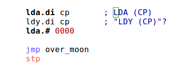

Color can have more uses. Take this snippet:
You'll note that in the second line, ldy.di cp is not bold. That's because there is no instruction LDY (CP) (more's the pity) and I've set up vim to bold valid mnemonics as I type. This eliminates a whole class of errors, because after a while, your subconscious goes "uh, wait a sec" if an instruction doesn't turn bold. It's like a minature "confirm" for every instruction. The blue for jumps/branches and red for halts is nice, but in retrospect not really necessary.
(I've been trying to figure out a similar system where the editor will recognize Forth words that are in the Dictionary (or have been just defined), but the effort would seem to be in no relationship to the gain. It's easy here because Typist's' mnemonics are 1:1 for the opcodes, there is a fixed set of 256 of them, and vim is awesome.)
Does it just overwrite your comments?
My personal preference is to not have those "helps". The Forth compiler will tell me right away anyway if an instruction or addressing mode is not defined.
