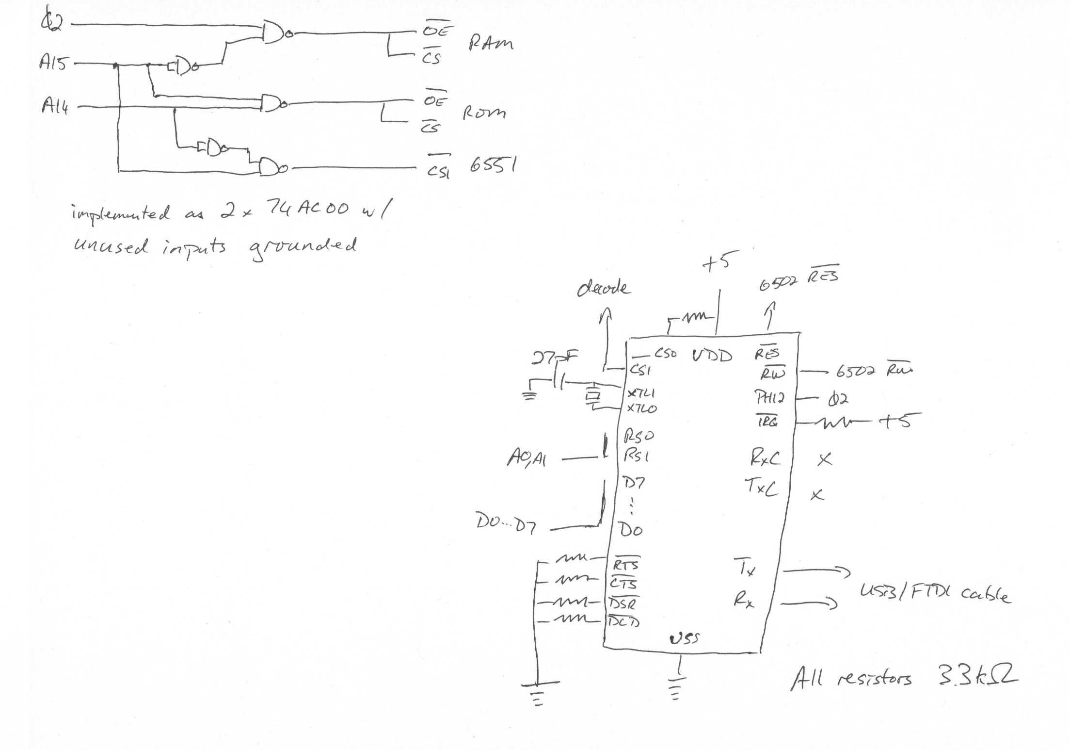

Thanks for suggestions. I'm attaching the relevant parts of the schematic. I hope you'll forgive my hand-drawn version... I'm not sure what tools people normally use for these?
The address decode logic is based on a circuit from Garth's primer. This works successfully in the other tests I've done that switch between code in RAM and ROM. The 6551 isn't slaved to PHI2.
I'm likely tying some lines that I could ignore up or down on the 6551. All the resistors are 3.3kO.
Anything obviously wrong here?
Thanks again -- and Merry Christmas to everyone!
[An update: As Hobbit1972 noted later, I messed up on one label when drawing the 6551 schematic. For "TxC", read "/DTR". Sorry!]

IRQ, DTR, RTS are outputs, so no need to pull them down.
What do you mean with TxC? 6551 has no such pin. But DTR is missing in your schematics.
The datasheet and the schematics I looked up don't have the capacitor on XTAL.
Did you make sure that TxD and RxD are not swapped? so that ACIAs output goes into PCs input and vice versa?
Can you read & write the command register?

Hobbit1972: TxC was a stupid mistake on my part when I was doing the schematic. Apologies! Yes, there's no such pin. The missing pin on the schematic is DTRB, which is not connected. In case I got TxD and RxD the wrong way around, I've swapped them back and forth each time I've had a different test, but with no luck. Adding the capacitor with the crystal was in line with one of Garth's circuits in his primer. I haven't tried to see if I can read from the control register, though; that's a good idea and I'll try it out (although of course I lack any other source of output right now, other than address line hacks!)
Floobydust: It's a 3.3V cable, although it claims to be 5V compliant. In particular, it is this one: https://www.adafruit.com/products/70. I've tested the transmit code in the SYMON simulator, and it worked fine there (slightly different ACIA address, although in fact it's mirrored in my design anyway). Here are the initialization and transmit parts of the code:
Verify that you can write a bit pattern to the control register and read it back before anything else. If that fails then you need to troubleshoot your glue logic. Watching /CS1 with your logic probe while you've got the MPU in a read loop would be a good idea. If you can see that the device is being selected then you may have a defective part.
One other thing to try if you suspect your crystal isn't oscillating or isn't oscillating at the correct frequency is to substitute a 1.8432 MHz can oscillator, which is what I would have used right from the get-go. Cans always work, whereas crystals can on occasion be temperamental. Connect the can's output to XTLI and leave XTLO floating.

I just did a quick test in line with the suggestions here, and confirmed that I can successfully write a pattern to the control register and read it back again. So, the chip select, data lines, and address lines would seem to be working? I'll do some more testing on that tomorrow -- but for now, I've got a Christmas dinner to cook.
