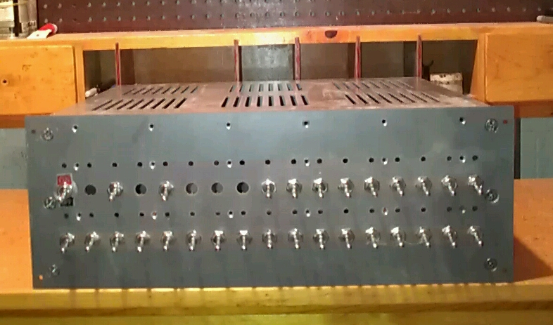

Several years ago I had started a project very much like this. I don't know that I'll ever finish it though; I have no time to devote to it. The only part I did finish is the most trivial: the rack mount case and front panel, hardware only. I wonder you'd be interested in what I have.

KC9UDX, that's a nice panel, but I have access to a laser cutter/engraver, so I'm planning to do my panel out of red acrylic. As an aside, I'm looking for a source for some NKK paddle switches, the M2012TNW03-EC. Nobody seems to stock them. I know the imsai.net folks have vintage paddle switches, but I'm not building a reproduction.
