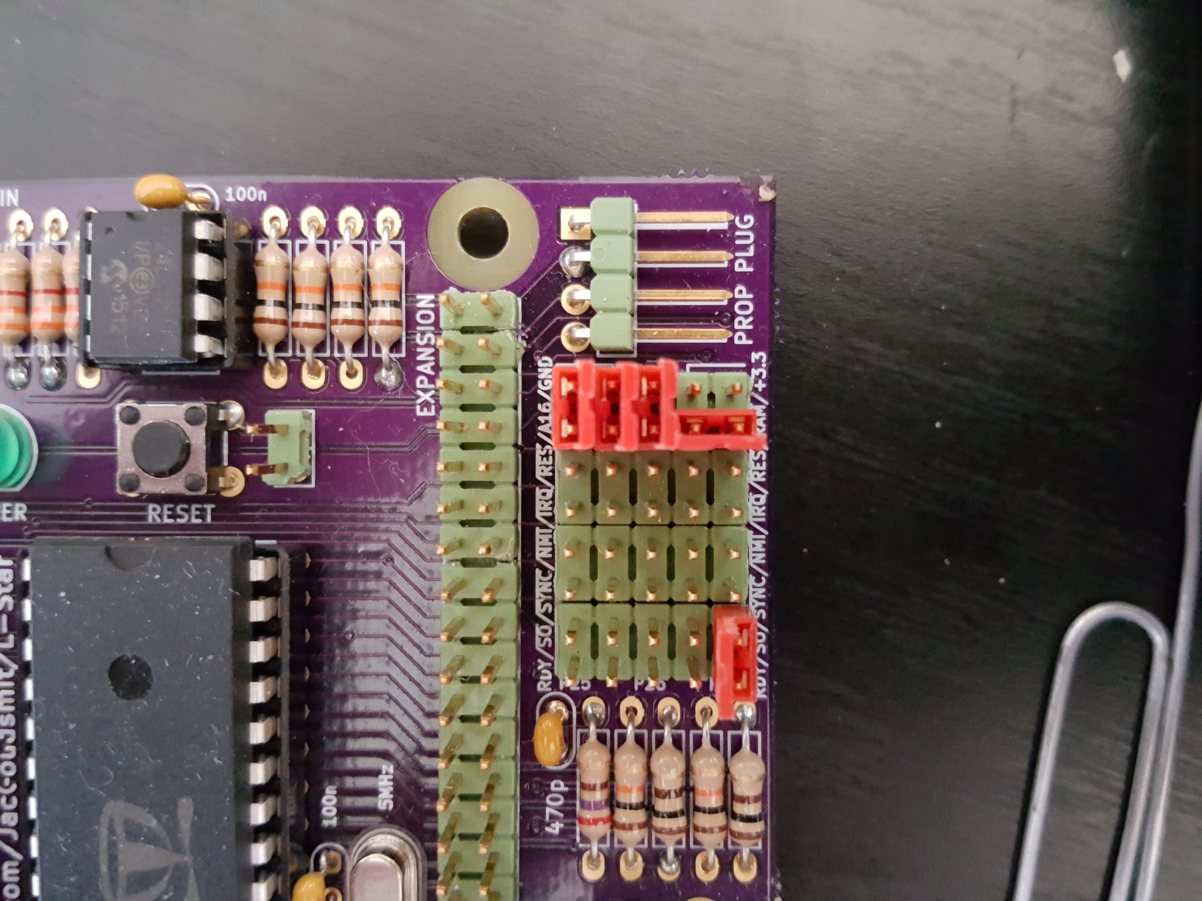

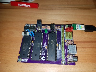

Got my L-Star+ built. It went together easily in one sitting. I loaded the Apple 1 SRAM firmware using the propeller tool. On power up, the Propeller is fine, and I get the welcome message and the ROM size message. The computer recognizes the keyboard space bar properly and the video works fine on my vintage Apple monochrome monitor.
But I get no response from the 6502 - just a repeating lowercase 'p' character over the serial console and also the monitor. I've rechecked all the solder joints - not saying I could not have made a mistake, but after about 5 checks, don't see any.
I tried another WDC 65C02 I have, no change. Another SRAM I have, no change. The frequency of the repeating character varies with clock speed - I tried slowing the clock to see how that affected it.
Interestingly, the behavior changes depending which ROM .bin file I use. The AppleSoft file does not give me the repeating character. So I'm leaning towards it being software related. I have not yet tried the other emulated machines yet. Going to ride my bike for a while and see if it fixes itself ;)
-G
For the Apple 1 SRAM project, you need to change the jumpers to connect !RAMEN to P27. See the picture.
I admit, the documentation is lacking on this (I should write a README). The "hardware.spin" module of the Apple1SRAM project has a diagram that shows how to connect the jumpers.
In the picture, I just parked the fifth jumper on the P27 header on the bottom right; you could leave the jumper off, too.
Sorry about your bad luck. If you would have tried the regular Apple 1 project first, it would have worked.
Hopefully it doesn't keep you from playing with it, and discovering stuff (I'm taking notes to improve my documentation). And congratulations on posting the first ever picture of L-Star that was not taken by me :-)

Set the jumpers, reloaded everything, and up popped the Woz monitor! I admit not recognizing it at first due to its minimal nature ;) The 6502 is running for sure now. I think it was before too - I saw the "\" prompt among all the other characters but didn't recognize it for what it was. Now to find out where the BASIC interpreter lives ;)
