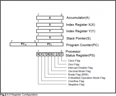

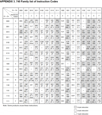

While looking a bit around in the internet, I accidentally stumbled over the 740 microcontroller family from Renesas.
Anybody familiar with this ?
rej09b0322_740sm.pdf [1.05 MiB]
Downloaded 95 times
Edit: looks like the 740 wasn't mentioned for the first time here in this forum:
http://forum.6502.org/viewtopic.php?f=1&t=1212&hilit=740&sid=608d9d74dba38d77b1d66048818ad33f
http://forum.6502.org/viewtopic.php?f=4&t=216&p=1388&hilit=740&sid=608d9d74dba38d77b1d66048818ad33f&sid=608d9d74dba38d77b1d66048818ad33f#p1388

An interesting find, very like a 'C02. Two interesting things about it:
When ADC instruction is executed in decimal operation mode (D = 1), execute at least one instruction after the ADC instruction before executing a SEC, CLC, or CLD instruction
X modified operation mode flag T
Bit 5
This flag determines whether arithmetic operations are performed via the Accumulator or directly on a memory location

Haha, there's something familiar with that picture, for this forum..
I did run into the 740/38k maybe a couple of years ago. But I had forgotten about it.

More things there too:
    multiply and divide (at least optionally)
    ones-complement operation
    rotate by four bits
I think this little machine deserves a review of its own!

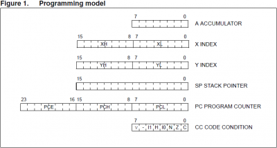

BTW:
While the instruction set of the STMicroelectronics STM8 microcontroller family looks pretty different from the 6502,
the register set looks a little bit familiar... somehow.
