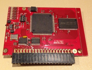

The physical implementation we have is the Matchbox Copro, a small board by Jason Flynn with an LX9 FPGA, two pseudo-static RAM chips, power regulation, and level conversion for attaching to a 5V host bus. (Normally that bus would be the Tube connector on an Acorn micro - it's the 6502 data bus, some control lines, some address lines.)

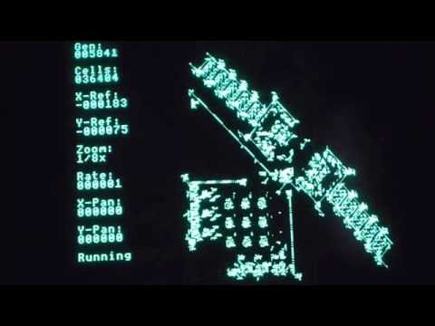

As a demo and a driver, Dave ported a Life program to this platform and we're able to run a large pattern (almost certainly for the first time on a 6502) - a Turing Machine:
Although the matchbox physically has 2MByte of (pseudo-static) RAM, it's not byte-accessible without a tad more effort, so we use only half of it. It wouldn't be hard to add another 120 pages of slower RAM, probably at the cost of an extra cycle of access time.
At present the Matchbox runs up to 64MHz with a 65C02 version of Arlet's core. Several other MPUs are also supported but this mapping story presently only applies to the 6502.
