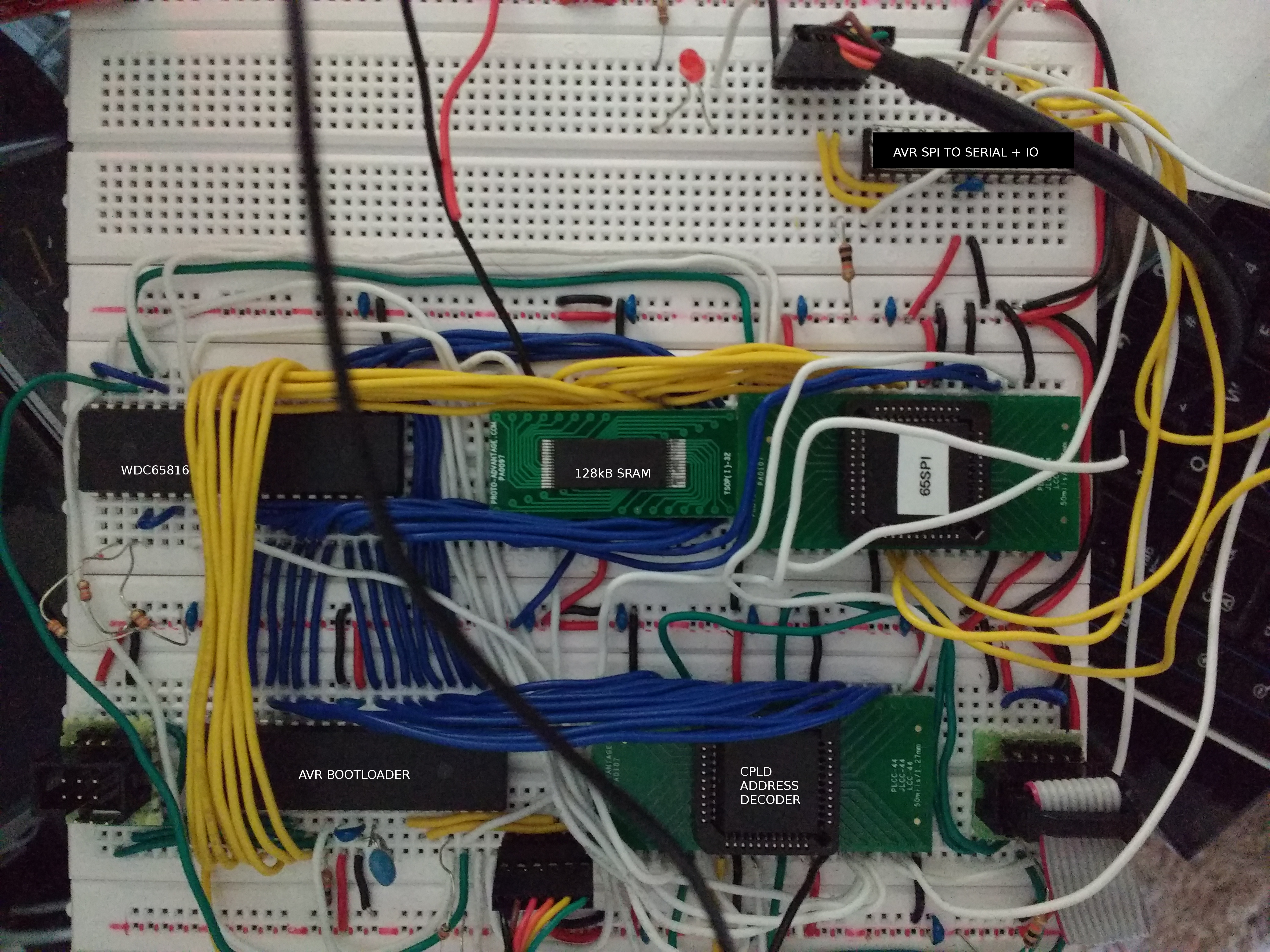

Hey everyone, I'm in the middle of building my first 128kByte 65816 based machine with SPI, Serial and AVR based ram loader and clock control. Address decoding is done using a Altera CPLD (MAX7000), this gives me quite a bit of flexibility.
I'm learning the ropes by building it on a breadboard first and plan to make a real PCB in the later stages. The AVR allows me to control the clock pulse by pulse inspecting the address and data lines as well as frequency control from 1kHz to 10MHz. Currently it is executing a very simply assembler program that creates output using a serially connected VT100 terminal (currently Putty). Total code size is 354 bytes :) I'm pleased that it runs at 10MHz on the breadboard.
Now to the question, is there any documentation on the WDC816CC calling convention? I'd like to mix C and ASM in my home brewed OS to go along with the hardware. The PDF from WDC is woefully short on information.
File comment: board with labels

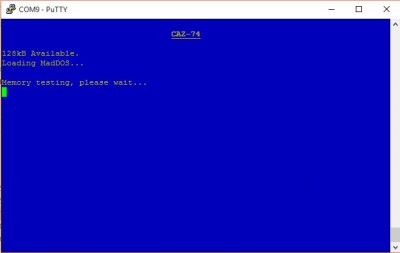

File comment: first output of machine.

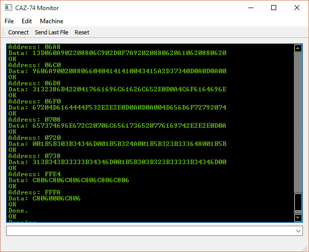

File comment: hex file uploader and clock controller.

Welcome, altera -- nice project! Not too shabby, for someone who's just learning the ropes! 8)
It looks like one of Daryl's SPI Controller Devices you've got there, am I right?

Thanks, I'm very happy with how it's turning out.
That's right that is one of Daryl's SPI controllers. Works well!
